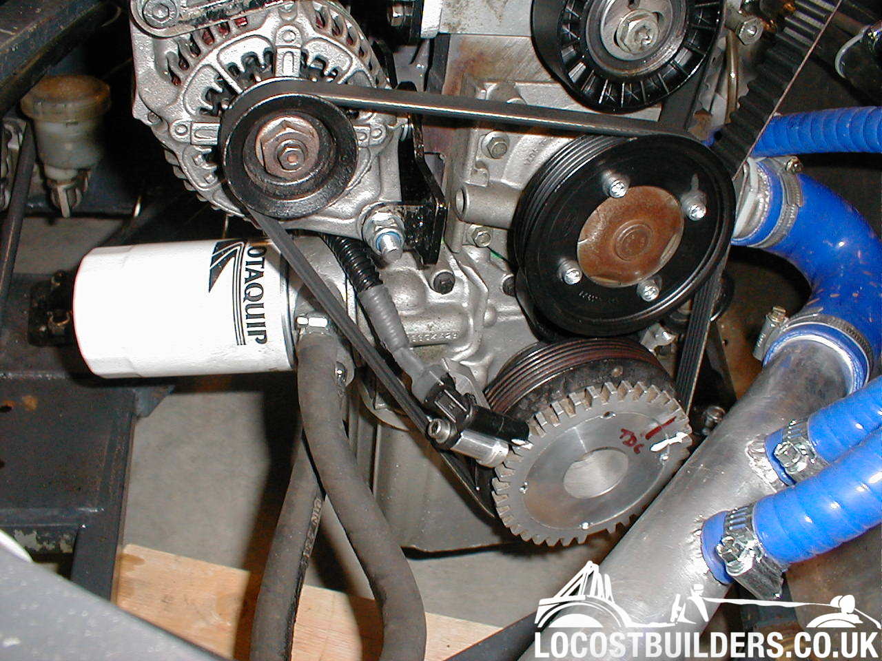

Lsdweb is your man
pic from his archive
link

lsdweb
posted on 3/2/08 at 09:08 AM Reply With Quote
As big_wasa said, I did just that and it worked perfectly. I had some long debates about whether the rubber mounting of the front pulley would affect the timing at high revs so we machined it so that the wheel located to the central part of the pulley not the rubber mounted outer bit.
I was using an Emerald ECU so I could easily set this all up. I'm not sure how you'd get away with it trying to use the standard ECU if that's what you're doing.
I did it because I was using a CVH flywheel which can be lightened more than the Zetec one.
If I go Zetec again (still undecided) I'll do the same again!
