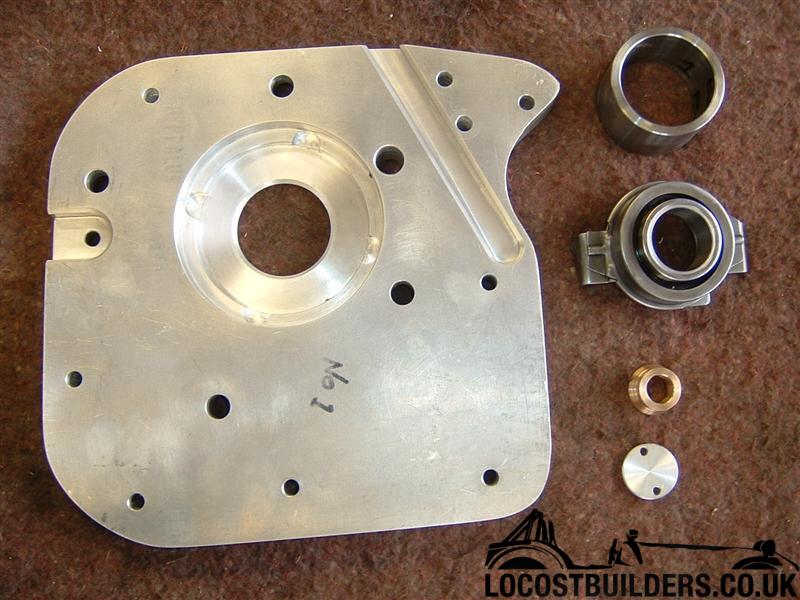

Johnmor
| posted on 29/2/08 at 10:14 PM |
I used a conversion plae to adapt the bell housing from a 164.
Works fine, done about 700 miles and no problems, uses the hydraulic clutch from the 164 and a friction plate from a sierra.
DIY Si
| posted on 29/2/08 at 10:18 PM |
What mods were required to the alfa part of the bellhousing? Was the plate hard to make, or just a simple bit of milling?
Johnmor
| posted on 2/3/08 at 07:12 AM |
Hi
There were no mods to the alfa bell housing apart from chopping of the diff box at the rear, the rest of the bell housing is as it is. The plate was
milled from 25mm aluminium and allows the alfa bell housing to simply bolt on to the Type 9 using and the same bolt holes are used to bolt the plate
to the bell housing.
There is a.lso a minor mod to the alfa thrust bearing to allow it to sit in the type 9 slide tube, just a new slide tube on the bearing.
A simple phospher bronze bearing is used to support the box shaft in the alfa fly wheel.
A freind of mine with a great little machine shop made the plate but i suppose a engineering company might charge a couple of hundred quid for the
work as the milling has to be very accurate to prevent any vibration and the gearbox must be accuratly centred in the bell housing for the primary
shaft to run true through to the flywheel.
The bell housing is not as neat as Orwellys solution, but for me it was an easier proposition and as this attaches where the alfa gearbox was mounted
it will also work with any alfa engine that used that gearbox so I think any engine used in the 164 could be used.
