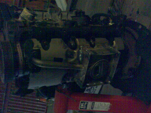

Standard modeo sump

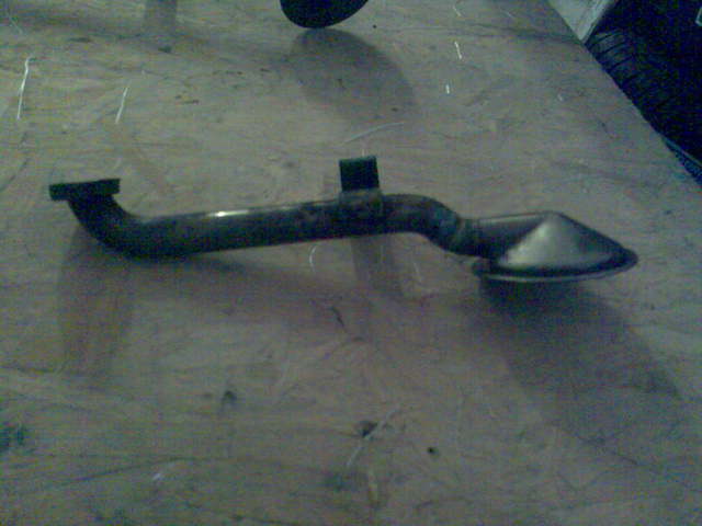

modified pick up pipe

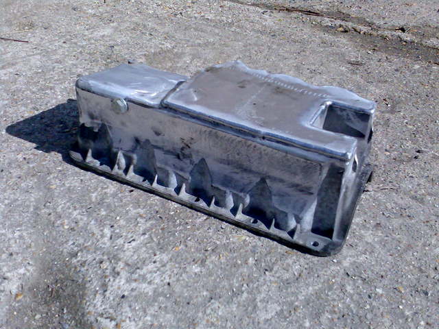

Shortened sump

big_wasa
| posted on 24/3/08 at 02:00 PM |
Is that tig or mig welded ?
cheers
madteg
| posted on 24/3/08 at 02:05 PM |
Sump
Looks fab but will oil get into the baffle box quick enough.
scotty g
| posted on 24/3/08 at 03:29 PM |
the sump is TIG and the baffles on the windage tray are MIG.
the pickup pipe and the baffles are 5-6mm clear of the bottom of the sump so there should be no problems getting enough oil to the pipe. A mate of
mine is running a 2litre zetec with a shortened sump and no baffling at all and had no issues for the last 4 years or so.
i guess only time will tell!
