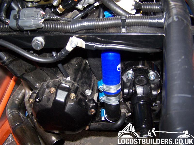

Hi, just looking for pictures and advice about mating the sierra propshaft to my ZX10R gearbox shaft? I know some modification and adapters are needed however if anyone has any pics or tips id be very grateful.

usual sliding joint front end to prop adaptor, I used a new prop instead of modifying a sierra one which cost around 150 quid

That pictures a great help ! Thanks very much. Anyone with a MK indy and ZX10R setup? Cheers
