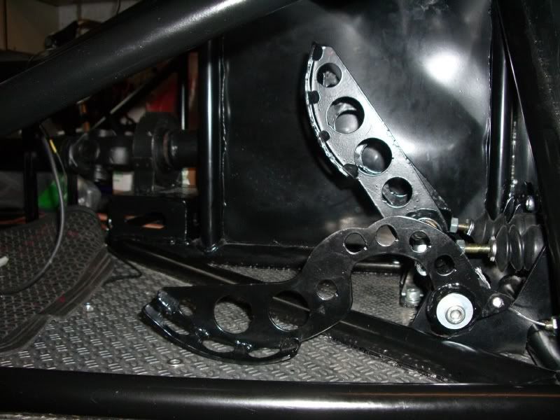

| posted on 10/10/08 at 10:42 AM |
Ok heres a pic
So how does the angle look - ok or too far forwards? Generally should a clutch pedal be infront of or behind the brake pedal? I dont think i can do
anything about the brake pedal unless i cut some of the mc piston rod off both sides that enter the bias bar. With the clutch pedal if i moved the
locating hole lower and away from the driver would this decrease the amout of travel in the pedal to operate the clutch?
Called Marc of MNR and said to make a stop, thinking of using a floor mounted bolt to hold a hard rubber stop which sounds like it should work as i
can see a spring possibly popping off.
Thanks again
Adam

| posted on 11/10/08 at 06:04 PM |
well, i'd say they look fine to me. the push rods look a decent angle, and with the pedals that far forward, they have to be pushed further
before the hinges at the bottom get in the way of your heels

| posted on 12/10/08 at 11:23 AM |
Cheers il leave them as they are untill ive got the seat and wheel in place and then see again if they need moving
