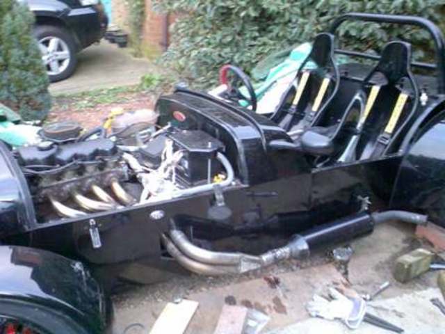

I made mine by cutting the flange plate of my old CVH exhaust and welding on a 4-2-1 set up. It was easier to do than I thought. Two helpful tips are to allow it to be seperated where it exits the car in case you need to remove the exhaust at a later date and to cut the pipes square with a hacksaw use a jubalee clip round the pipe Rescued attachment Image054a.jpg

And mine
I went for 4 - 2 - 1 equel length, the lamda sits in the last collector. You will not get the perfect lengths as the cars are not long enough!
I made the collectors by splitting larger tube and welding in triangles.
Held it together with masking tape around each joint then spot welded through.
You have to be logical in order as some joins will be impossible once its all together. Rescued attachment Zorst.JPG
