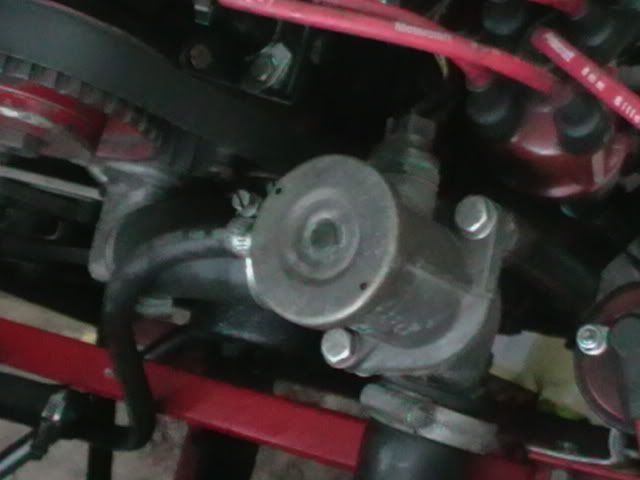

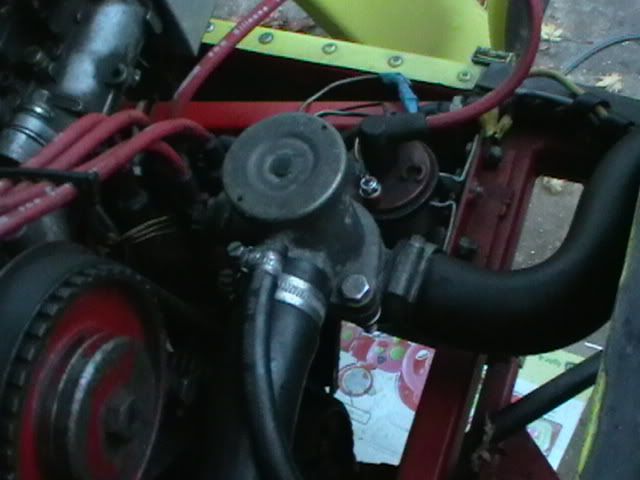

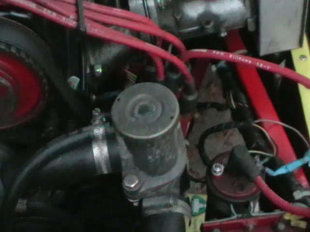

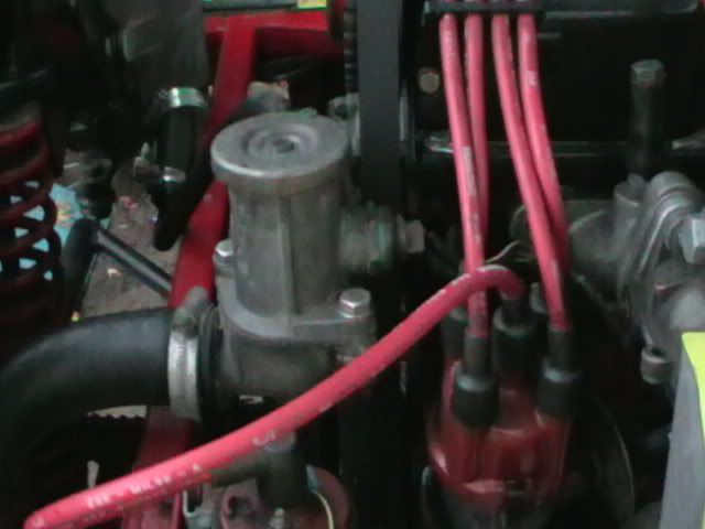

posted on 20/10/08 at 05:07 PM Reply With Quote
right, i had a little peak today and got a couple of pics.
I dont have the fitting on the rad to have a switch so i am leaving that as i dont want to drill it really.
What i am not sure on though is what i am showing in the pics, it has a filling cap on it and the relief pipe runs to a small tank.
Do i have to keep this in or can i get rid of this all together and use my ally expansion tank instead??? It does have a switch or sensor off the back of it. Any ideas what it is??? i didn't have time to trace it.

goaty
posted on 22/10/08 at 07:37 PM Reply With Quote
anyone know? i assume that the switch is the temp sensor......
