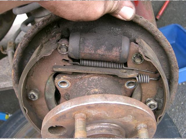

big-vee-twin
posted on 9/6/10 at 02:10 PM |
Here's one
![](/galpreviews/2202.jpg) ![Sierra Drum](/gallery/2202.jpg) Sierra Drum

gavin174
posted on 9/6/10 at 02:24 PM |
Looking at your's big vee..
I would say the bottom spring spring is the wrong way round
and should sit in the gap between the shoes,not rub on the shoe
Might be wrong thou

flak monkey
posted on 9/6/10 at 03:22 PM |
Whatever it is, its not sierra....
The pic BVT has posted is sierra - most definately.

adithorp
posted on 9/6/10 at 03:56 PM |
Might be wrong thou
+1 Agreed! ...but a common and easy mistake.
