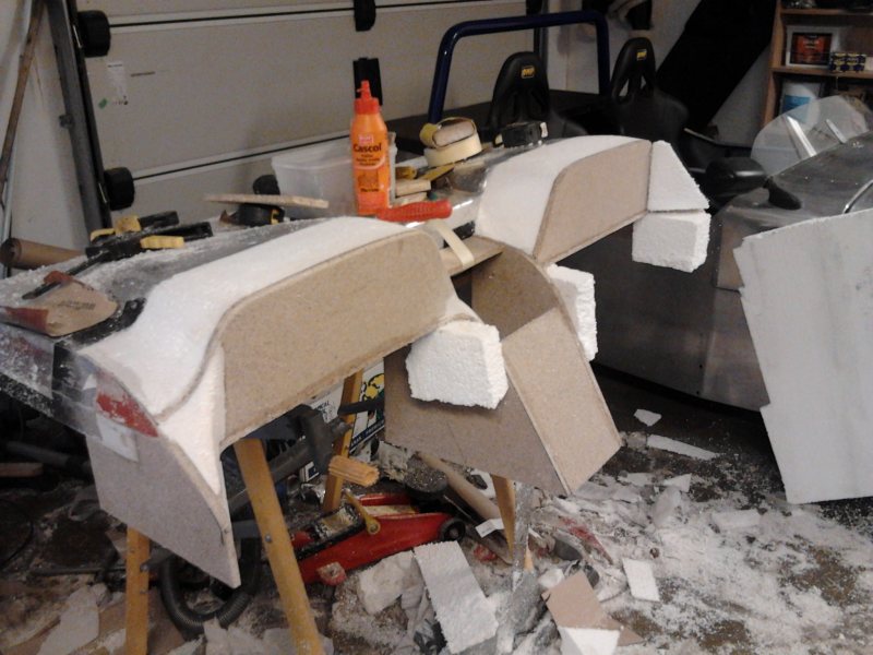

First i had a vinyl covered sheet of plywood like classic style.
I got tired of unbuttoning all just to pick something out of the boot... so started up modelling in styrofoam just the way i wanted it.
And it ended up like this:

Svante, that looks excellent! Would look awesome in carbon fibre!

For such a comparatively small design change that makes the car look a whole lot better, very nice work Svante!
