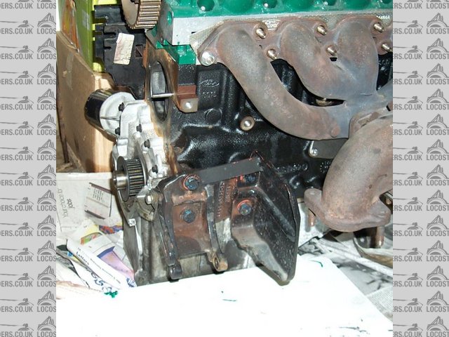

hmmm, will it fit on my engine??

Got a pic of the side of your engine? i'll tell you if it will or won't...

lets try again, bit more room this time
![](http://i51.photobucket.com/albums/f374/spunky18/DSC07647.jpg)
Fatboy Dave
posted on 26/1/08 at 11:36 PM |
Can't seeclearly around your engine mount, but two of the three mounts (the square land above the waterpump outlet and the one between numbers 1
and 2 primaries in your second pic) are certainly present and unoccupied

this is tricky without seeing what you have in mind!
Fatboy Dave
posted on 26/1/08 at 11:47 PM |
Scratch that, I'm talking bobbins, I wa slooking at the wrong lands. I think you've used the opnes required for your engine mounts
