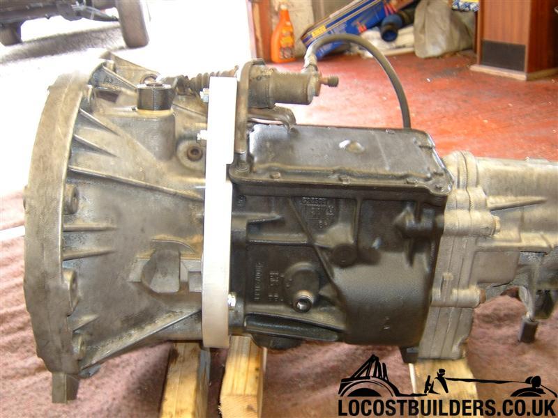

Do you have the original FWD gearbox?
The route I've been going is to use the original FWD bellhousing (after being tickled with the angle grinder to remove the diff housing) then
making up some adapter plates to bolt it to a ford box. With this, I'm able to use the original Rover hydraulic clutch, with a mondeo friction
plate:
http://bills-locost.blogspot.com/search?q=build+day+80
Wouldn't recomend a type-9 like I'm using for anything more than the factory spec 200bhp, and even then, a HD one is probably a good idea,
but the theory should work with other boxes.
Please note, I haven't tested this yet, so it could all end it tears
Build Diary: http://bills-locost.blogspot.com/
Web Site: http://locost.atspace.com

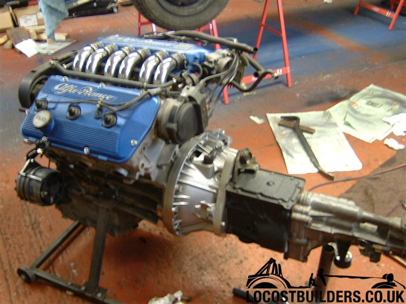

Johnmor
posted on 25/5/08 at 10:35 AM |
Using the bellhousing and making a conversion plate worked for me!!
![](http://www.locostbuilders.co.uk/upload/Engne%20and%20gearbox.JPG)

bilbo
posted on 25/5/08 at 07:03 PM |
Cheers Bill, that looks the dogs danglies there. I was thinking of using a Sherpa back plate and just redrilling it to suit the Toyota box. people put
these boxes behind big V8's and they come out of Supra turbos so should be ok for me here!
Looking at your pics there I reckon the starter will be a problem as my chassis is built around the Ford type 9 bellhousing. I'll have a look at
it anyway as the housing looks a lot shorter than normal RWD one.
Whats your plans for a water pump by the way??
For the water pump, I'm planning on using a davis-craig electric one for simplicity.
The starter was a bit of an issue to me as well. It means the engine is a bit further forward in the engine bay than I would have liked. The FWD rover
bell housing is 5" long as apposed to 7" for a standard ford type-9 housing. You can see how close the starter will be to the chassis rails
in the pic below.
![](/galpreviews/a748892-IMG_0141 - small.jpg) ![Rescued attachment IMG_0141 - small.jpg](/gallery/a748892-IMG_0141 - small.jpg) Rescued attachment IMG_0141 - small.jpg
