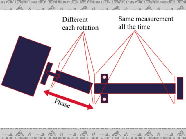

According to the vibrate website
On vehicles with two piece propshafts there is an odd joint. The working angle of the odd joint should be kept below 1/2 degree and above zero
degrees. This is because there is not a companion U-joint. Think of the front piece of a two piece propshaft as being an extension of the transmission
output shaft.
1/2° is not practical in my application so now I may have to rethink the engine position
The designer will have specified a material rigid enough to stop the prop from whirling like a skipping rope which is why it is made in two pieces to
keep the thickness down, not to get round a corner like we use it on a Locost, so the movement will be translated into fore and aft and be operating
at an angle to the centre bearing.

so what kind of way must I follow?
cheers
Amadeu

Amadeu
As you can probably guess, its quite a complicated subject if you want to get everything "textbook". In reality most installs are a
compromise of some sort but what's been discussed about balancing two of the UJ angles and keeping one almost straight is a good starting
point, so either like mine (with the rear UJ almost straight) or with the front UJ almost straight with the rear two cancelling each other out should
give acceptable results. If you want to look further into the technical stuff, have a look
here.
As for the slider, you've seen the arguments for and against positioning it at the front so I'll leave that one for you to decide on.
cheers
