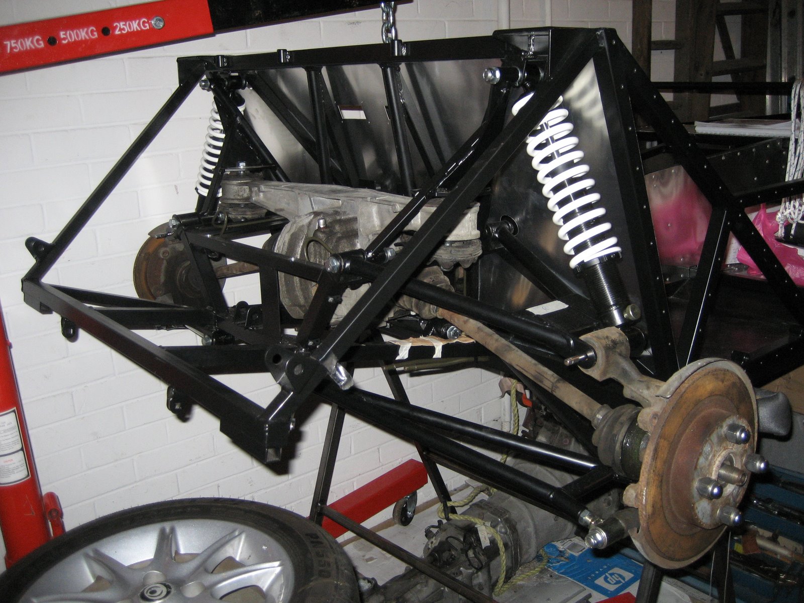

I could do with some pointers please. I'm building a Haynes base, with MX5 running gear. The rear wishbones are causing me a little confusion,
mainly because I'm using a Talon diff cover and not the normal two-armed MX5 diff. What it means is that I'm aiming to use the Sierra
wishbone design but with alterations to fix to the MX5 uprights.
On page 77 it describes an adjuster that works the same as the Sierra adjuster, and it seems to make sense. The problem is the Sierra design has the
suspension damper mounted on the upright, which doesn't work on the MX5 upright as there isn't a mounting. What I was going to do is put a
plate on the upper wishbone, as seen on the Saturn plans. But then that puts suspension loads through an adjuster, and I get the impression
that's a bad thing to do.
Is there any way of keeping an adjuster on the outboard end of the wishbone, or do I need to relocate it somewhere else?
Have a look at roadrunner racing.
They have a bracket just in from the outer adjuster to mount the damper to.
I think westfield bolt it all through the upright. I guess that would be fine if you used a rosejoint on damper and top wishbone.
The MX5 upright is offset at the top so it should all align nicely.

Personally, I'd think about re-designing the wishbone so that camber adjustment is by shims, sandwiched between a clevis (attached to the upright) and the end of the wishbone, with a couple of bolts holding the whole lot tight together.
Originally posted by Slimy38...That would give me a bit more strength, compared to everything coming through a single screw thread.
Originally posted by Sam_68
Having said which, an equivalent to the 'Sierra' design shown on page 69 would doubtless be fine:
