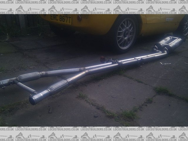

Since the post man did the business this morning and turned up laden with stainless bends and tube , I got well stuck in and made these -
I did have to pop in to work first thing to borrow a welding mask - mine packed up , and after only twenty years

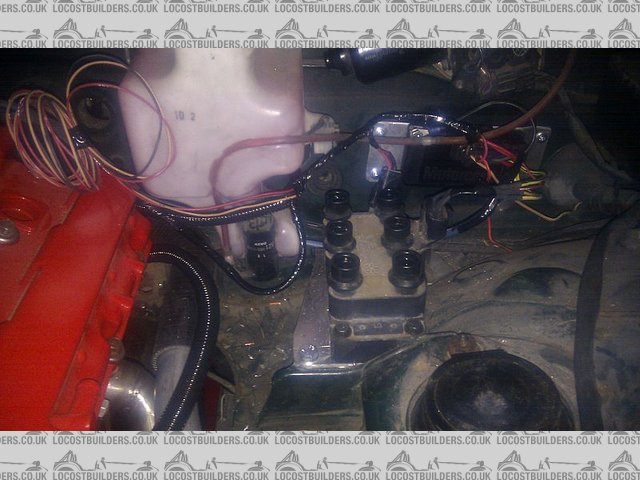

Now that the rubbish Easter weather is over , I got under the bonnet tonight after work and fitted the exhaust manifolds , and oil filter `bracket' (along with the stock oil to water cooler)
They were a bit of a struggle , getting past the steering column was not easy , but as the first complete manifolds I have ever made I am quite chuffed

clairetoo - 24/5/12 at 09:49 PM
All it took was a few warm dry evenings - and I now have a finished exhaust !
2" all the way to the back , then two small box's (same as on my Fury) , it just needs a small cutout in the center of the bumper

adithorp - 25/5/12 at 11:23 AM
Those look erm... NOISEY! Not sure that'll fit your image.

And this is where the noise will come out........
There has been a lot of progress over the last two (sunny ) weeks - but nearly all of it is electrics - not exactly exiting stuff , but the wiring is about 90% done (I'm just waiting on a set of plug leads and a crank sensor)
I have allso got the coil and edis mounted and wired - with all the engine wiring running through a spare hole left by deleting the air con .

Not much.....I just picked up my new custom Magnacore leads , the posty has delivered my VR sensor , and I have the relays and fuse box sitting on the kitchen table
