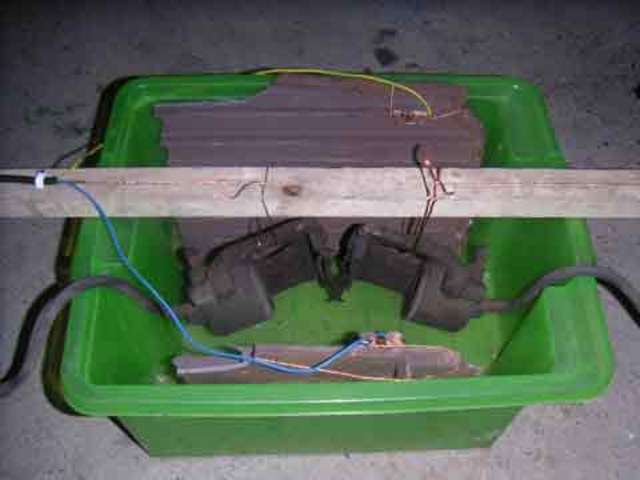

Opened it, read it, was sceptical, then tried it anyway. Wow!! I just cant find enough stuff to 'electrolyse'!
I first tried one of my 4x4 front uprights. I had already drifted out the bearing outer races (a complete bitch) and given it a good 20 minutes of
'The Tool' - not the soft wirey one but the voilent twisted one that leaves you looking like you have a piercing fetish, not to mention the
instant parkinsons/arthritis. It was still covered with stubborn lumps of rust especially in all the hard to reach places.
After several hours in the tank, the rest of the rust fell off in my fingers under a tap (or with a tiny bit of wire brush persuasion), and with a
quick dry in the oven it looked every bit as good as the day it came out of Henry Ford's finest casting shop. Totally amazing and no effort or
money!
Then I tried my other upright straight off the car, covered in years of filth and rust, left the bearing races in. Same result. Awesome! All the
crap just rubs off with your fingers!

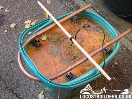

It's fantastic. I used baking soda and it works fine. I use a bit of thin walled 6" diameter stainless tube i found as the electrode, and
occasionally a small bit of inch tube to insert inside tricky bits if required. Draws about 2 amps with the electrode nice and close to the piece.

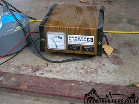

Very cool. Although it doesn't say anything about the kind of charger or voltage to use. I have a car battery charger kicking about, so as long as that's ok I may just give it a go.
Didn't really know what the hell kind of soda they were on about in the faq but baking soda is fine. Water softener which claimed to be soda
based didn't work.
I just use my halfords car battery charger which is essentially nothing more than a 12V power supply capable of supplying a few amps. The current
drawn depends on how close you get your electrode to the rusty lump of crap. Draws about 2A for me.

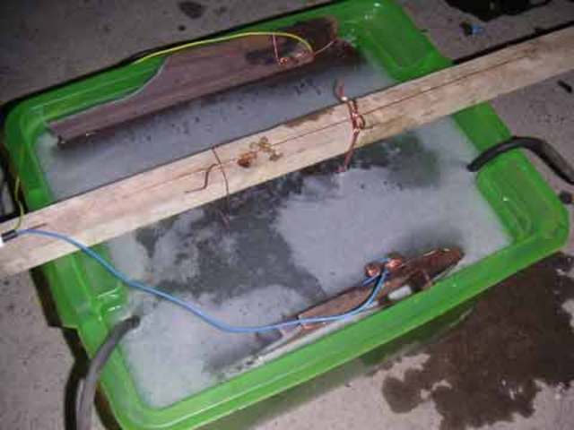

From this...
To this. With no effort. Apart from a bit of a rinse/scrub, prime and a squirt of WD40 into the bits i dont want to paint.
This happenned while i was asleep!

I tried it last night with just a bit of RHS as the anode. It worked a treat but i'm going to make one out of some sheet because it'll get
better results. It sort of works on "line of sight" because the current will flow along the easiest path, so if you make the easiest path
wider you get better coverage. I'm not sure if my explanation was good or not but that's how I see it.
The solution gets very manky very quickly though! I looks like someone shat in it now
My electrode is a piece of thin walled stainless tube about 5" diameter. Was gonna strap it under my 205 for that 'big bore' look but
I think I've put it to better use now.
Surrounding the object dont seem massively important if you leave it in long enough. I tend to turn the rusty object round about half way to try and
'expose' the other side to the electrode. It just works much faster close to the electrode cos more current can flow.
I had a stubborn bit inside one of my uprights so i switched my normal electrode for a bit of inch round mild tube so i could get it in there. That
learned that bit of rust to stick to my upright. Even after a few hours though the mild steel electrode was getting fairly well eaten, wheras the
thin bit of stainless I usually use hasn't been touched.

Needed a battery charger for some time so thought now is the time and i can try this de rusting process too.
Inot Halfrauds and out with a nice looking all singing all dancing charger.
Halford Auto Charger
Got the washing soda and a nice stainless serving spoon (90p) and a plastic washing up bowl.
hooked it all up and nowt seemed to be happening.
Theni discover this "fully Automatic" charger is to fecking clever for its own good.
It only supplies power to the leads once it is connected to the battery, i guess it will detect some resistance of someting and allow power to
flow.
I tried it with the power on and touched the 2 clips together and nowt!

Col,
Only thing to watch for is short circuits as the battery will supply a huge current if you short out the anode and cathode. A battery charger will
only supply maybe 4 Amps before its internal protection will start to shut it down. The other downside of a battery is that it is always live so you
won't be able to turn off the power so easily when rearranging the piece being derusted. Obviously you could just use jump leads but you
don't really want sparks when connecting and disconnecting as this could potentially explode the hydrogen.

Right I've got it set up and it seems to be doing a good job.
Here's my setup:
I used some ribbed cast iron plate as the electrode, it gives good surface area and is working well.
I just hung the items up with wire, this didnt connect to one suficently so only one caliper was de-rusted, adding an extra conductive lead solved
this.

Tried a bit of 25mm tube at first and it worked slowly so i made a half circle out of sheet steel that i use on mot repairs and it works great.
There is some rust proofing on the steel that is leaving a green residue all over the plate is this normal or some other more devious chemical
reaction.

Just spent two hours watching my hubs bubble away and WOW this really does work. This is going to save so much time and mess now all i need is a bigger plate and tank.
Now i've got it going can you answer a few questions lads.
At the moment it only draws 1 amp from the charger. It's a 12volt jobie and i'm wondering if the process would speed up if i changed to 24v
instead.
Is it possible to up the current by altering the solution at all.
Or am i just being impatient and inquisitive for more information.
Add more soda crystals, that'll speed it up. And move the metal plate closer to the thing your cleaning.

Finally decided I'd better get on and refurb the front uprights and callipers.
Not sure why 'd put it off before but finally decided to give electrolysis a go.
The electrodes were just off cuts from the chassis which I wired to a piece of copper tube resting on a bucket. The solution was washing soda at a
concentration of approx 1 tablespoon / 5 litres of water.
[img]http:// [/img]
Battery charger didn't show much current but overnight the process worked very well although I did have to wire brush it fairly thoroughly
afterwards.
[img]http:// [/img]
Anyway, if youre thinking about electrolysis then give it a go. just wish I knew about the process when I was restoring my Austin 7!

I've been using electrolysis too. I remembered it from school 25 years ago. I found Ajax scouring powder, water and vinigar to be best. I've
experimented with washing machine tablets - ok for light rust as is normal washing powder.
I use a high current battery charger but don't let the positive clamp drip into the water! The positive clamp will soon fizz away and by morning
you'll be left with just a dangling wire. For most parts I leave them a couple hours, but I had a set of really rusty hub carriers that had been
painted over with some kind of hammerite. They took nearly 24hours to come up clean. They looked beyond saving, yet once don't they sparkled and
even the seized bolts came straight out - no effort.
click here to see my super 7th heaven locost project and more info on electrolysis
