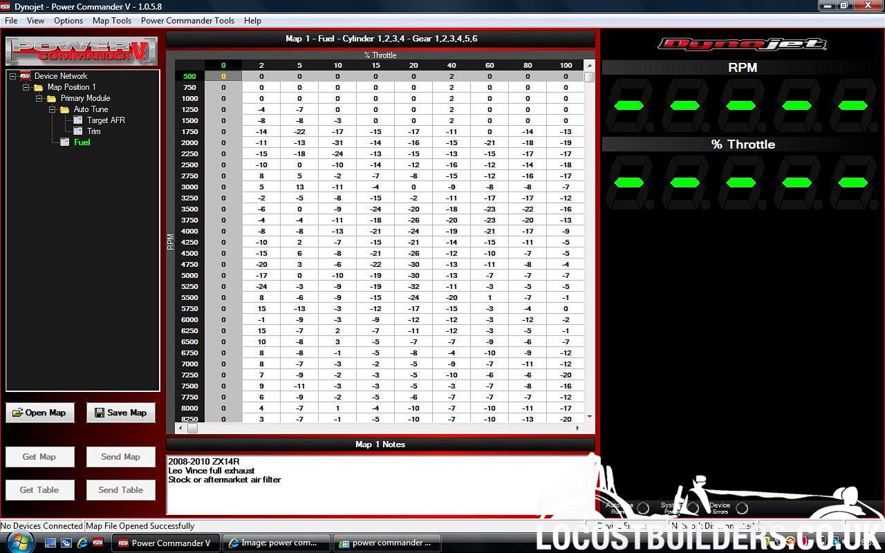

ZZR1400 PCV map
What do you guys/gals think think of this map

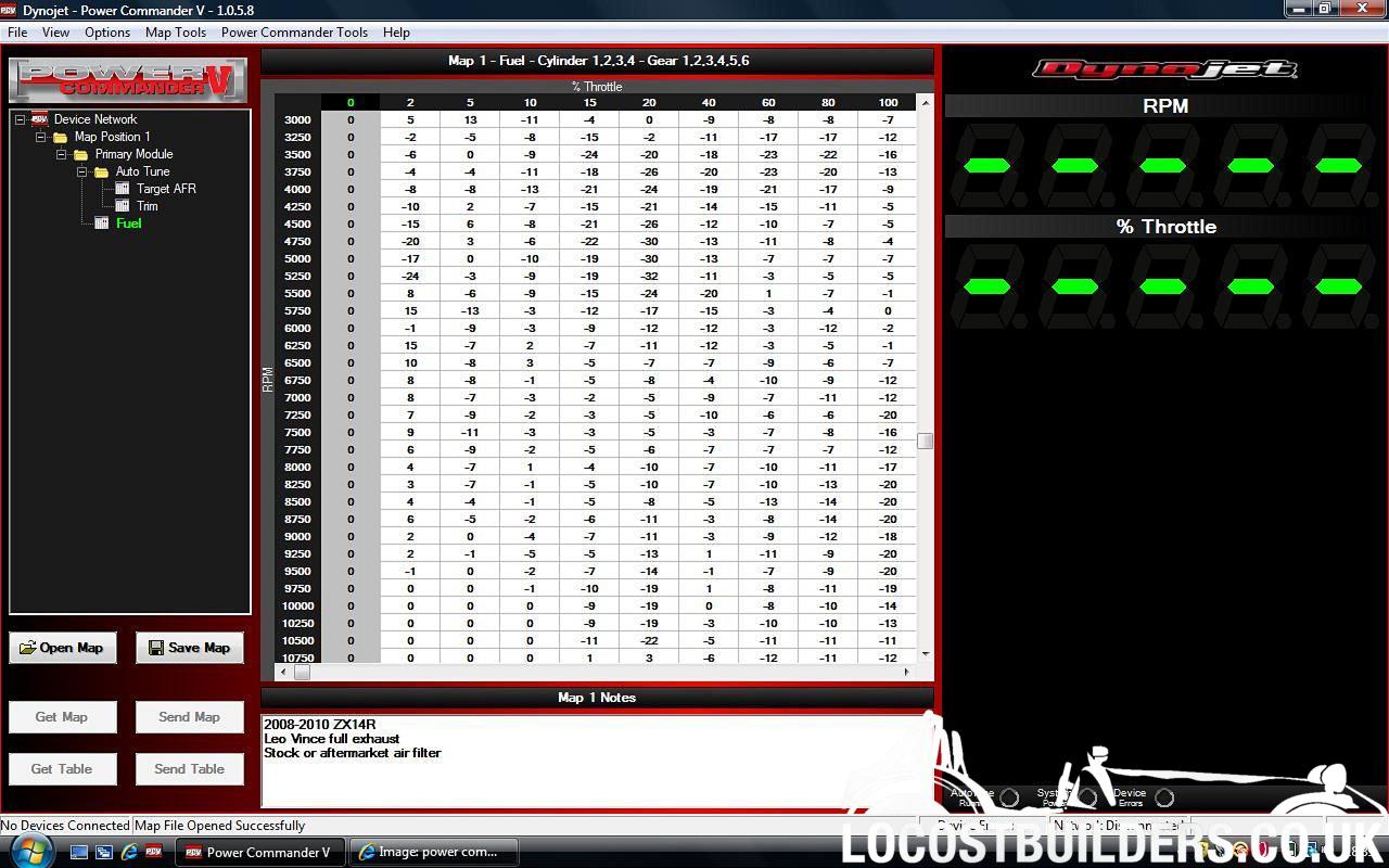

im using the autotune as an add on to the power commander V i have it set as defualt to adjust +- 20%
i do seem to have some very high - % as default the autotune AFR is around 13.1/13.5...should i have that lower say around 12.5 ish
[Edited on 28/6/11 by Johneturbo]
Johneturbo
posted on 11/7/11 at 06:16 PM Reply With Quote
Just an update on this... i emailed the map with the Autotune settings to Damian at Daytuner and he was kind enough to a look and gave me some tweeks to try with the AFR, but it wasn't that far out as default. So big thanks to Damian for taking the time, real nice bloke to chat to
