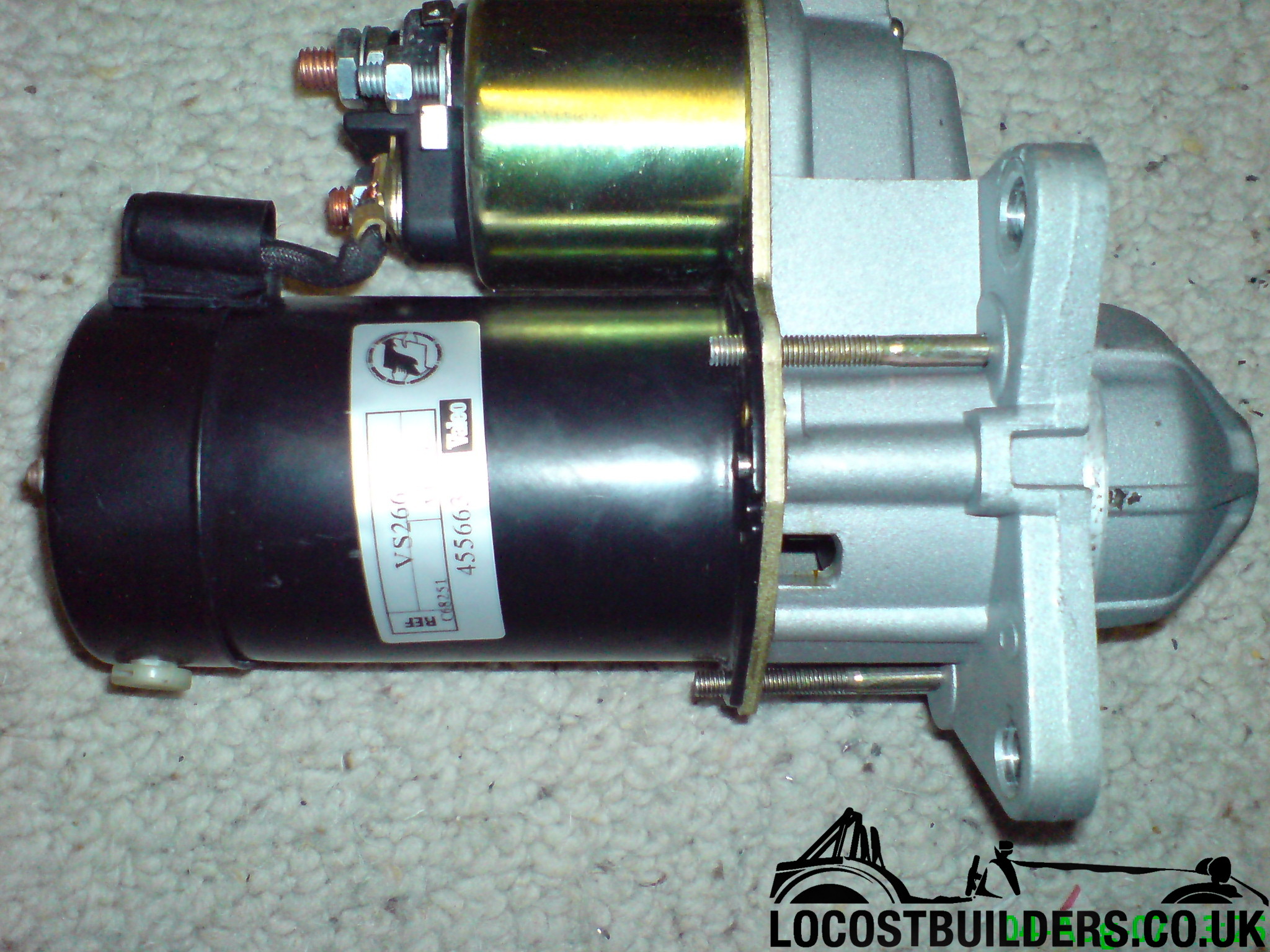

valeo do a very slim starter...
http://www.locostbuilders.co.uk/upload/DSC00248.JPG
VS2666 - it might help your situdation.
with this starter, i did no grinding to the sump.
