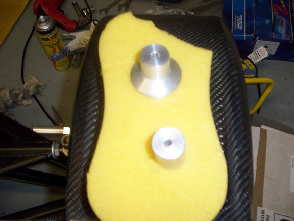

posted on 8/11/08 at 09:21 PM Reply With Quote
Yes - spacers required; had mine turned in the end after I decided I wasn't happy with the straight ones:
