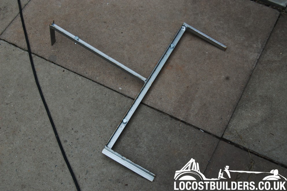

loggyboy
posted on 2/3/09 at 12:37 AM Reply With Quote
Please excuse size!
