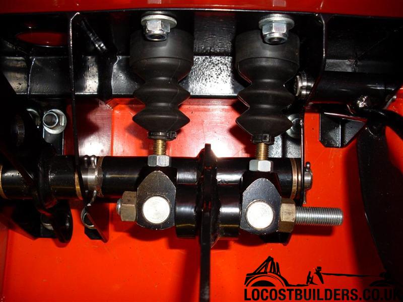

other question, would you go bias bar set up?
ReMan
| posted on 7/5/09 at 11:07 PM |
No not essential, neither is a balance valve
SVA with it fully open and I've still not touched it 3 years on

I'm glad you have started this discussion - I am at the same crossroads myself and, after having read the replies, I am going to stick with
drums.
As far as the Bias bar goes, I have already fitted mine and, after reading the info posted in other areas of this forum regarding the new IVA rules -
I wish I'd not bothered.
In case you aren't aware, you set your bias bar up, then permanently fix it so it can't be moved again - with SVA drilling and pinning
locknuts was sufficient - with IVA you have to weld the locknut and also along the rest of the thread.
I have to ask - what if you've set it up wrong?
