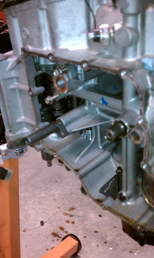

Tonight I was in the process of putting on my Rilltech wet sump pan and notice the engine has this pipe coming out. Anyone know what its for?
In the manual I found it with the words "breather Pipe". Not sure if this should be sitting in oil or not. The word breather some what
leads me to think no...
I am building a MK Indy R with a 2008 Hayabusa engine.

Its the oil return pipe.

Yep it's the oil return back to the sump. I have had to cut it a bit shorter to fit my sump on.

Thanks, thought that is what it might be.
