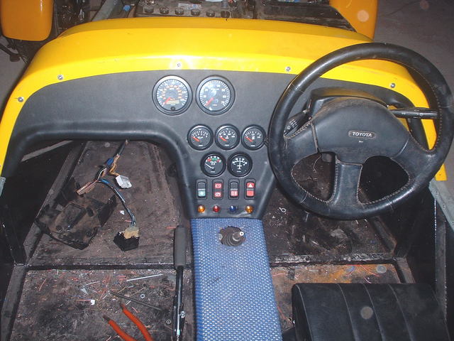

Just finished having a bash at a new dash. Thought I would post a pic. Done to match the interior panels I've just done. Just need some LED
washer jets and I can join the Saxo set!

splitrivet
posted on 1/12/04 at 11:30 PM |
Very cool zetec, nice clocks ,what make are they.
Bob
scoobyis2cool
That looks really nice, how did you make it? What materials?
Pete
It's not that I'm lazy, it's that I just don't care...
zetec
posted on 1/12/04 at 11:37 PM |
Clocks are from greengauges.com and are CAI or Smiths as they used to be known.
Real locost job this. All of a £1 on 10mm MDF and about £5 for black vinyl and blue leather left over from the interior panels and some glue.
Spend a couple of hours with a jigsaw and glue pot and job done. Takes longer to think of a design that it does to make!
Good cheap fun.
scoobyis2cool
posted on 2/12/04 at 12:11 AM |
The joins between the black and blue bits look recessed, how did you do that?
Sounds a nice cheap way to improve the car, mine is a bit of a tatty SVA job so that's one of my jobs for christmas
How are you planning to attach it to the scuttle?
Pete
[Edited on 2/12/04 by scoobyis2cool]
zetec
posted on 2/12/04 at 01:52 AM |
Me and mr Jigsaw. Cut the bit out you want in a different colour, if you are really carefull you can use the bit you remove, cover it and fix it back
in the hole. If like me you are none to carefull cut the shape out you want, then transfer cut out shape to another piece of MDF and cut and cover
that. Just fix the parts of the dash together at the back.
I don't like to see the fixing screws on a dash so I drill and countersink some 6mm setscrews around the outside of the dash. Before covering
the dash mark and drill the scuttle to accept the screws. Once ready to cover the dash just put some body filler over the recessed screws, rub down
and they get covered over. The filler stops them from moving when you come to join the dash to scuttle, use wing nuts as they are easier to do up than
trying to get a spanner behind the dash. Simple, just like me.
