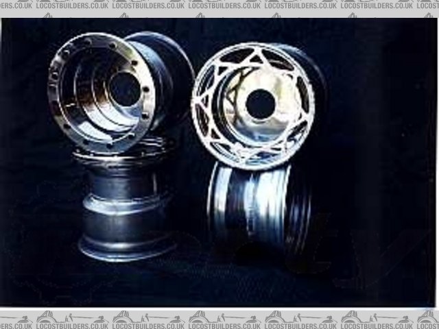

spin my own wheels from sheet aluminium
Now a pic or two of that would be interesting
John

Rorty
posted on 15/12/02 at 10:55 PM Reply With Quote
It's a very simple process, but I don't have any pics of the actual process, just the finished articles. There's a good symposium on metal spinning at http://www.kochmetalspinning.com/metal_spinning.html
If you have any specific queries on the wheels I make, I'd be glad to help.
Cheers, Rorty.
