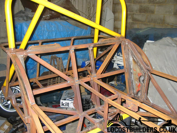

I've got mk high back fibreglass seats and did mine like this to get some extra height on the mounts:
http://www.locostbuilders.co.uk/upload/cockpit%20bulkhead.jpg
I welded the threaded tube to the extra 1" piece before i welded them onto the top rail.
Ned.

that was my plan ned,where you get threaded tubes?

ned
| posted on 6/5/06 at 10:31 PM |
made them up on a mates lathe, though they took bloody ages! i'm sure most kit manufcaturers can supply them, mk, mnr etc etc etc
