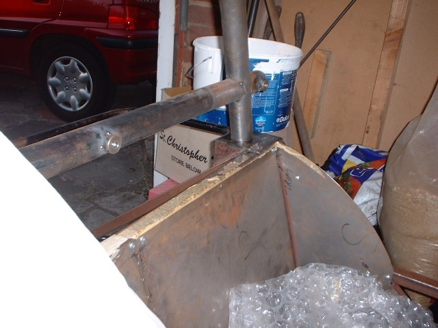

| posted on 1/8/06 at 09:29 PM |
I have mounted mine in the roll bar, but using an additionional horizontal bar, but am still in build stage, so not tested yet.
Liam

JohnN
| posted on 1/8/06 at 10:38 PM |
I have my harnesses fixed to the roll bar cross bar, and passed sva that way. The only complaint from the tester was that the harness connections
themselves were too sharp. I had to add protection to these connectors.
Photo shows full depth threaded insert welded top & bottom and eye bolts to screw in
  Harness Mounts
