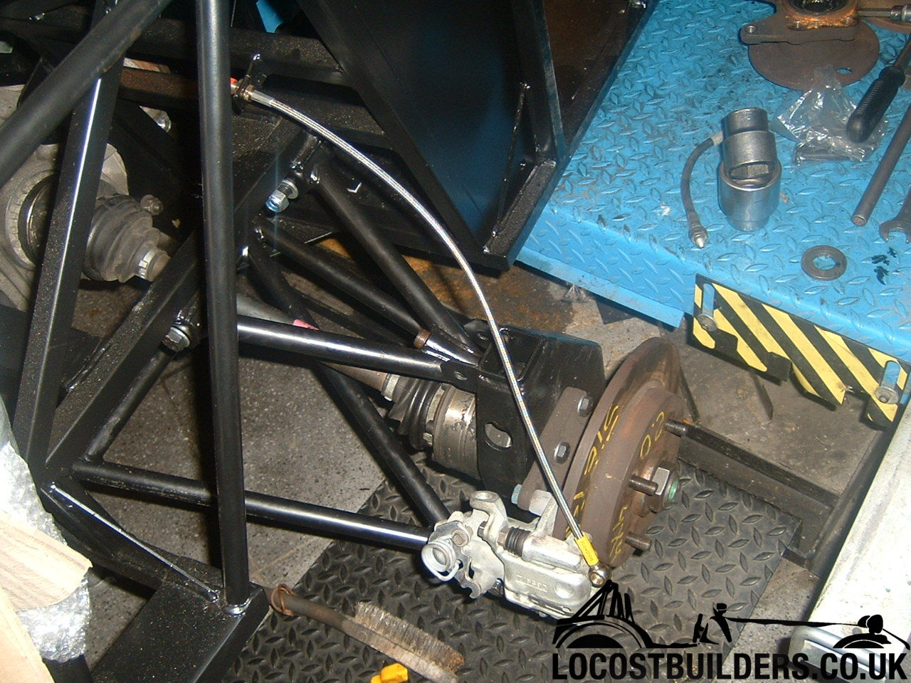

posted on 28/11/06 at 07:27 PM Reply With Quote
no you don't need it watch this!
http://www.locostbuilders.co.uk/upload/03122004%20004.jpg
i have them facing the wrong side..

FlansS14
posted on 29/11/06 at 10:23 AM Reply With Quote
Thanks for that. i thought they were ment to go on the front have you got the hubs on the wrong sides then.
also which side has the left hand thread! :S
