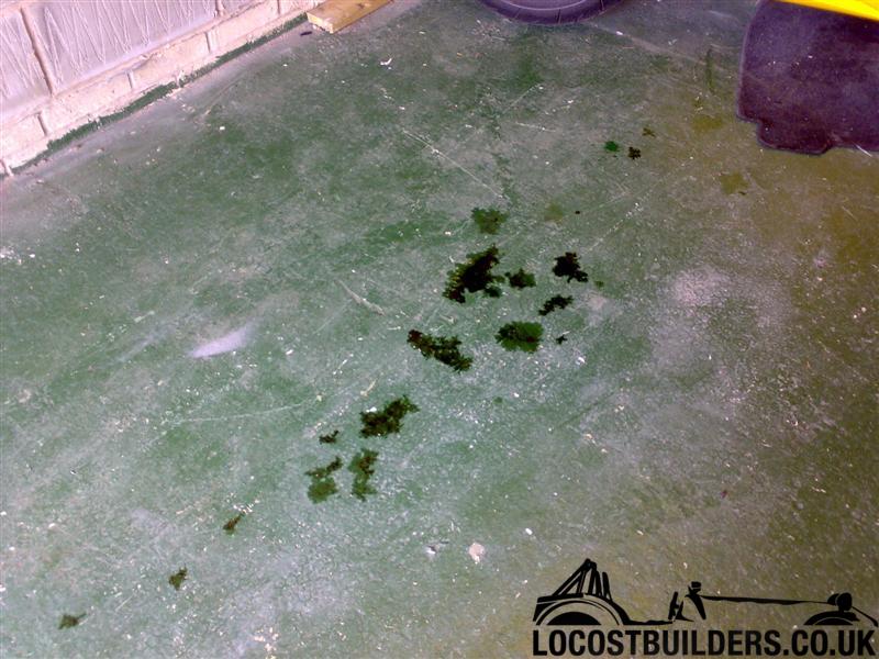

have i broke it!
after some "enthusiastic" driving on the way home from stoneleigh on sunday, i parked the indy in the garage, moved it today, and was
presented with this...
the bottom of the car is covered in oil, as is the lower part of the engine (pinto)
looks to be coming from the sump gasket is it possible to change the gasket with the engine in situ?
Ray

i thought pintos did that anyway ?

are you sure the sump bolts just haven't worked loose? bit strange for the gasket to need replacing just after a bit of enthusiastic driving.
just a thought.

you checked you dipstick pipe. they skake loose
Where is the oil coming from?

With oil leaks i usually wash the engine first and then look for the leak as the oil spreads and you can never be sure where its coming from.
| posted on 9/5/07 at 10:56 AM |
As above, best thing is to clean it as much as possible then re-check to see where it's coming from. My pinto has developed a small leak and
it's proving difficult to find where it's coming from.
To answer your question, yew you can replace the sump and crank seals with the engine in situ. It won't be the cleanest or most comfortable job
you'll do mind

As above, clean the engine, dry it well and dust it in talc (will "clot" the oil and show up where its coming from- or thats the plan
anyway)....
The loss seems a bit excessive for a Pinto- for a Xflow I'd say its about right Have you been over any speed bumps recently? It's
possible to get a hairline crack in the sump that opens when the sump gets hot and lets the hot thin oil through....

Sump can be done in situ, bit of an arse to do while laying under a car, but can be done if necessary.
I would back up what others have said though. Try to find out where the leak is actually coming from before assuming the sump. Could be any number of
places, as all leaks tend to look like they are coming from the sump because the oil always finds its way down there.
To be serious, theres no reason why any engine should drip oil, even if it is old and british. If it does drip, its usually a reasonably easy thing to
fix. My pinto must be one of the few that doesnt leak somewhere, mind you that had a full rebuild.

My Pinto did this for weeks before i found that the leak came from the front crank seal, changed the seal twice, still leaked, then I fitted a genuine
Ford seal, leak stopped????????

During winter engine swap i went to great lengths to get it leak free and painted up. Leaked after a few miles! Quite annoyed as you can imagine. Leak
was actually due to poor breathing. Oil forced out of dip stick tube etc. Better breathing has improved it. Next job is changing the oil to 20W50 and
fitting the mooky supplied (many thanks Mark) Cortina breather / oil trap.

have you removed the one way valve [ breather in the sump ]
if not that may be the problem
Graham

Mine din't leak after a full rebuild either, but after 500+ miles it has developed a drip from somewhere

My pinto didn't leak until I had to change the rings, then after fitting a new gasket laid on my back under the motor it wee's oil out.
I will be changing the oil and gasket again after my first 1000 miles or so, (laid on my back again) hopefully this should sort it.
And yes it is possible but a swine to fit laid on your back. the hardest part is the rubber crank seals, getting them forsed into place in the groves
a few inches above your face.
