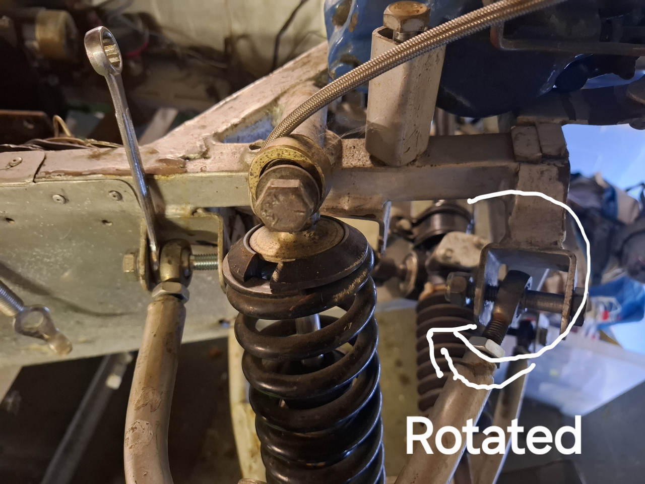

On dismantling, the pick up brackets appear to be similar to those in pictures of 750 race cars, although the front ones are rotated slightly rearwards, so they are at an angle when viewed from above compared to the rears. If we were running bushed mounts, this could never work as the mountings are not in line, but as I originally spec’d rose joints, I wonder if this was the reason as it centralises the front rose joint in line with the wishbone?

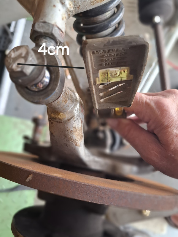

The top wishbones are asymetrical, allowing greater castor if fitted one way, & when I trial-construct the suspension taking this into account, (admittedly without spacers either side of the joints for speed of assembly), there appears to be ample visual castor comparing the top ball joint position to the bottom viewed from above. The centre of the top ball joint appears to be a maximum of approx 4cm rear to the bottom joint.

Is there a way to measure castor using the 4cm measurement approach above? (the car is up on a ramp with the engine currently out).

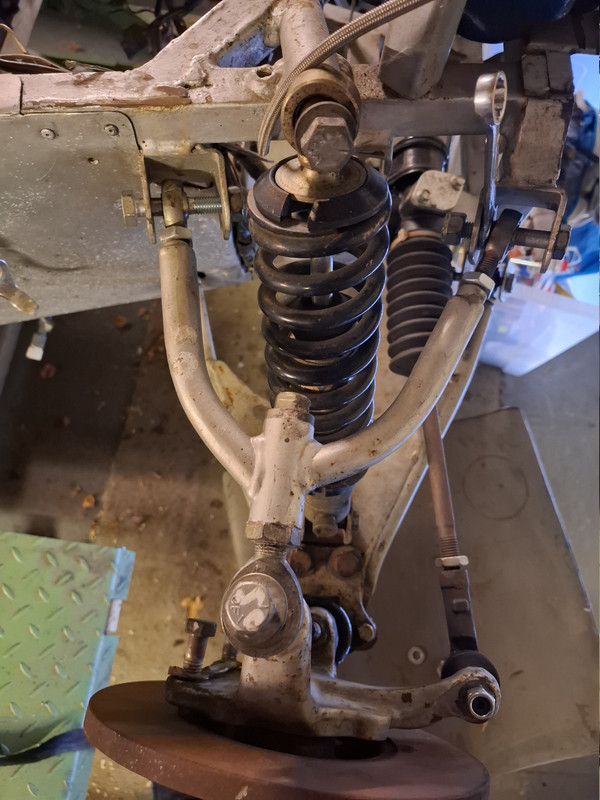

Finally, whilst the front end is apart, should the tie-rods from the steering rack to front hubs run parallel to the ground with the car loaded & on it’s wheels, or should there be an angle up or down between the rack & hubs?

I can only see your first photo! I find it easier to upload them to the archive here and then paste the forum URL.

What front uprights are you using? From the one photo I could see, it didn’t look like a cortina upright, which is as per book spec?
Front wishbones should be fitted in the orientation that puts the top ball joint as near the back of the car as possible.
Ideally the steering arms should be level when the car is stationary ie zero load.

If you also know the distance between the upper ond lower ball-joints (a), in addition to your 40mm (b) set back then a bit of maths will get you the castor angle. a/b = sine of your castor
Or if you've got a camber gauge... https://youtu.be/ox1TOwI2tD8?is=q6-pTVkSXzvvUNjO
You probably want 6-8⁰.
Ideally track rods, should have the inner joints on a line drawn between upper and lower wishbone mount centres (viewed from the front). The angle of the tack rod should parallel to the lower arm (if inner pickups are the same distance appart as the outer joints).
