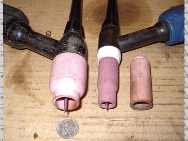

With ceramics, big is best. Pic below shows my torches.
On the right is the one that came with my inverter. Little ceramics are great for getting in tight angles.
The ceramic on its own is the biggest I've got.
The torch on the left is the same as I use at work, rescued from the bin, as a lump of hot metal burnt
through it. It's still 3.5M long, plenty for home use.
Argon exits a large ceramic at lower velocity and spreads more. Literally, better gas flow all round.
atb

Also make sure that you are using a rounded tungsten that is closer to the ceramic. The photos of the torch in the previous posts are set up to steel or stainless, because the tungstens are pointed and stick out further than the alloy setup.

Originally posted by 907
Hi Nat,
Proud? So you should be. Well done.
It's not just the money you save though,
it's when someone says, "that nice, where did you get that?"
"I made it" (smug grin)
What size is yours? (oo err)
atb
Paul G
Cheers Paul!
I do use a pretty big ceramic. I bought a load of smaller ones and some 1.6 tungstens but found that I got on much better with 2.5mm tungstens sharpened to a razor point, with a gas lens and a number 8 gas lens ceramic, that's what I used on all of the manifold.
Only tricky bit was getting between the pipes at the collector, where I just turned the gas right up and extended to tungsten about 1" past the cup!!!!!
