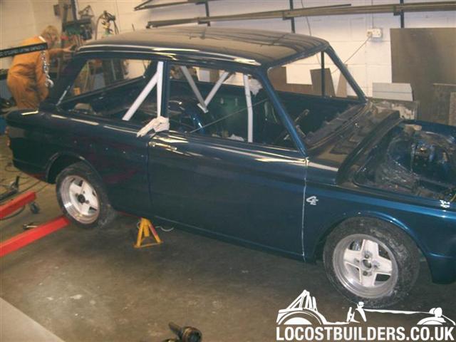

| posted on 18/2/07 at 06:13 PM |
zx12r imp
work so far the engine is in .click my picys to have a look hope you like it. its been hard work but thanks to paul at spire sports cars for all the
help

That should be good fun when it's done!
What made you decide to turn the engine round, and not have it as it is in the bike?

imp paul
| posted on 18/2/07 at 06:25 PM |
engine
imp engines live in the back the same way as i have the bike engine. also want to keep things looking like it should so it all looks the norm lol

arrybradbury
| posted on 18/2/07 at 06:41 PM |
I think the cage gives it away But looking awesome

SeaBass
| posted on 18/2/07 at 07:50 PM |
How does that drive layout work then??
Is it a chain across to a diff nose??
imp paul
| posted on 18/2/07 at 07:53 PM |
room no room
hi steve i had no room left in the back had to do some rear panel chopping nightmare fom hell as for drive lay out click my picys and you will
see
[Edited on 18/2/07 by imp paul]

G.Man
| posted on 19/2/07 at 09:32 AM |
PICS
Save everyone searching..
I like the drive layout, bit worried about the gearbox without cush drive on the diff tho...
The engine mounts don't look too solid to me, but I will stand corrected... I have seen 250cc karts break sturdier looking mounts than those!
No dry sump? Gonna accusump? Whats the plan?
Personally I would have gone mid engined rather than rear, but its your project not mine..

imp paul
| posted on 19/2/07 at 05:54 PM |
the frame is only tacked at the moment. it will be more sturdy when its seamed .as for the sump going to have the same sump as in the gtr kit car
baffled and modded pickup . also the gtr kit car at spire sports cars has no cush drive in the prop. and has done track day after track day and 8000
miles so no worries there then hope this helps a bit more o and thanks for the interrest hope you like it as much as i do but then im mad lol
G.Man
| posted on 19/2/07 at 07:13 PM |
8000 miles is nothing for a gearbox, just be prepared to replace a lot of expensive parts if it does break..
Kawasaki boxes are not amongst the best, and you wont know how much damage has been done to the box dogs until they fall off..
I doubt i will like it as much as you, as I would have used chain drive onto a reversing diff for adjustable ratios, better weight balance etc
etc...

imp paul
| posted on 19/2/07 at 09:29 PM |
g man imps handle like go carts so why would i want to mid mount it and make it all wrong .so that's why its meant to be in the back also
that's the hole point so it still looks like a imp

imp paul
posted on 20/2/07 at 06:04 PM |
my old engine 998 full race greetham
my old engine was a full race 998 made by greetham engineering and gives 130 bhp and revs to 10000rpm .same as grj engine and yes its mad but i want
some more power .hence zx12 engine fitted now .thanks to all of you for your thorts cheers paul o also no room for a cush drive or i would have had
one but all should be well
G.Man
| posted on 20/2/07 at 07:43 PM |
If you decide later to use a cush drive, think about using some rubber bushes in an enclosed case..
It would replace the UJ and fit in the same space..
10k on the greetham, very nice, bet that sounded sweet..
Pretty much bike engine RPM, but then that CC designed engine was pretty much based on their race designs...
PS. I used to work for a Chrysler/Rootes specialist back in the 80's so became very familiar with the Imp, Chamois etc...
