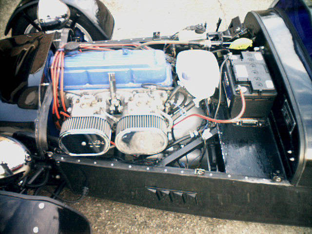

as promised engine bay piccys hopefully larger .i will put some more in my picture section if there is anything specific anybody wants to see give me
a shout and ill do my best to help hope this is of help gjn200?

suppose it would help if i actually attatched some piccys! doh!![](/images//smilies/tongue.gif) ![](/images//smilies/tongue.gif) ![](/images//smilies/tongue.gif) ![](/images//smilies/tongue.gif)
![](/galpreviews/a94920-pre-sva9.jpg) ![Rescued attachment pre-sva9.jpg](/gallery/a94920-pre-sva9.jpg) Rescued attachment pre-sva9.jpg

Good pics Tractorboy, thanks.
