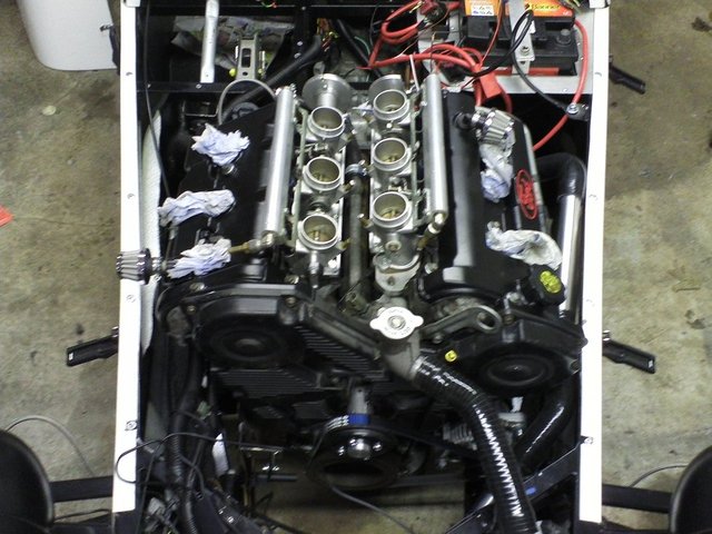

Claire managed to get my throttle bodies to me. These are 2 lots of Triumph triple 595 bodies on custom alloy manifolds, spaced to the KLDE ports and with Claire's own linkage. Claire uses Vauxhall 2.5 v6 injectors on custom fuel rails.
Here they are as they arrived.

ITBs in situ1 RB
ITBs in situ1 RB
ITBs engine fitted 2 RB
ITBs side shot RB
ITBs side shot RB
All looking good eh? They look great. Slight issue in that the bonnet clashes with the fuel rail on cylinder 1. This is the furthest forward and basically hits the flat of the bonnet in front of the scoop. So it looks like I will need to cut away the bonnet in front of the scoop and make a larger mesh cover. Always knew clearance was going to be tight. Shame as the rearwards itbs have loads of room above them where the scoop is.
I suspect I may have to run individual filters as opposed to an airbox unless I mod the bonnet massively. I am sure this will look and sound fantastic but not sure of the downsides? Thoughts welcome.

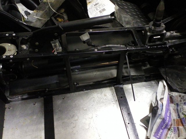

Fitted the manifolds and checked clearance on the steering column. TIGHT!
Manifold clearance RB1
Quick shot of the tunnel. Prop fitted and clear of everything Woohoo!. You cans see how high the gearstick sits but I am not concerned about this. A decent gaitor will cover that.
Tunnel final engine fitted RB
So a busy week next week getting it all wired and plumbed in. No doubt a few more issues to sort but the clutch is working. Made a custom hose up and in case I haven't mentioned it, am using an MX5 clutch pedal assembly, master and slave cylinders. We jacked the car up and check it is releasing ok. Good pressure and feel so fingers crossed.

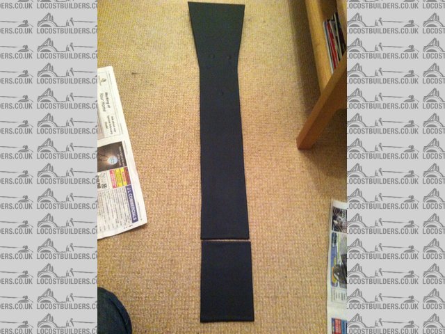

Made a small cover out of some thin steel for the gearbox tail that now sits proud of the tunnel top. It ain't quite as pretty as I envisaged but will do the trick for now. Mk2 version may be needed!
Gearstick surround rb2
Took them home and covered the existing tunnel top and the new piece in black vinyl. Looks ok will be fastening a new leather gaitor to the surround.
