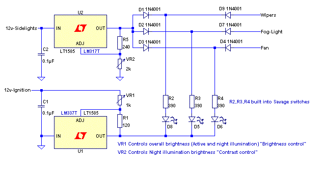

| posted on 17/1/06 at 12:41 PM |
Here we go:
This uses two voltage regulators, an LM317T and an LM337T (ignore the LT1585, CAD package didn't have the proper symbol). Both are cheap and
readily available parts. The LM337T is actualy a negative voltage regulator, but is used "upside down" in this circuit to adjust the
voltage at the LED's cathode.
The other regulator, the LM317T is a conventional positive regulator, that provides a fixed positive voltage at the LED anode when the lights are
turned on.
Both regulators are adjustable, and work like this:
VR1 controls overall brightness. This controls both the night illumination brightness, and the "activated" brightness of the LED.
VR2 controls only the night illumination brightness (in conjuction with VR1). Think of this control as a "contrast" control, it
effectively controls the difference between night illumination and "activated" brightness. This pot would likely want to be a preset
device that is set only one when you first install the system. The other one could be mounted on the dash for night time brightness setting.
This circuit only requires 2 extra diodes for each LED, which would probably be more convienient to build into the loom near the switches rather than
put on a separate PCB to save the amount of wires needed.
Any comments are welcomed.
[Edited on 23/6/07 by MikeRJ]
RazMan
| posted on 17/1/06 at 12:52 PM |
quote: Originally posted by MikeRJ
Comments are welcomed
My comment is WOW
That looks as though it will do everything we've been looking at in this thread.
Nicely done Mike

Id be happy to crack on with a strip board once Ive seen one and if you can supply maplin/RS part numbers that would be superb. As far as a full PCB
goes, Id need someone to do that for me as I dont have any equipment to do it.
Id prefer to have all of the components located in one case, to avoid much modification to the loom. However, I just realised now, the resistors are
already incorporated into the savage switches? So the only external components would be the diodes I guess.
Also, are D5 D6 and D8 zener diodes?
Im going to have a look again at the circuit and put it into a 2 way setup as I only have fog and fan, although I expect to add a push start at some
point (which ideally would just be lit when the ignition is on but the engine is off.....god how these things get out of hand)

MikeRJ
| posted on 17/1/06 at 09:45 PM |
quote: Originally posted by RichieC
Thanks for your time and the U2U Mike.
I However, I just realised now, the resistors are already incorporated into the savage switches?
Yes, those are repesented by resistors R2, R3 and R4 on the circuit. I don't know the actual values so I guessed. Not really critical for this
circuit anyway.
No, they are the actual LEDs within the savage switches, along with their current limiting resistors R2-R4.
