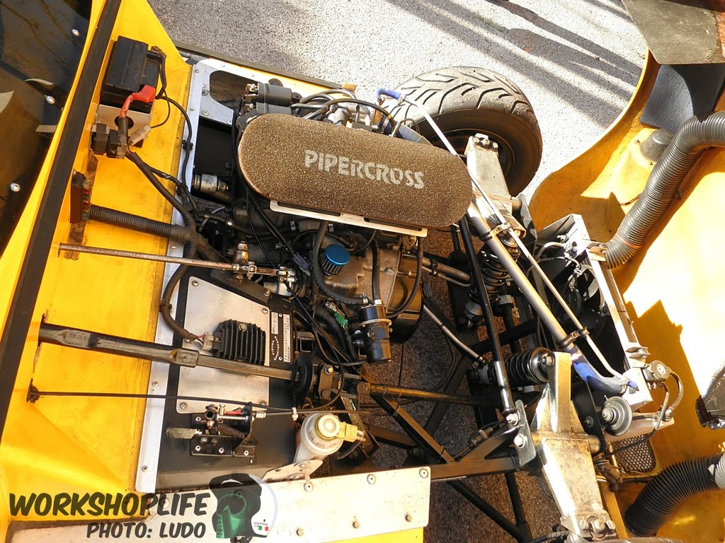

Well the exhaust manifold fits via the wheel arch, practically made to measure even though it's from a Quantom, it's back off to have the
lambda boss relocated.
Engine is now fully pumped in, took a bit of a creative approach to keep all pipes away from the exhaust side of the engine; I've flipped the
radiator 180 so that both inlet and outlet are on the passenger side, additionally the fan is now a sucker rather than a blower allowing it to sit
further into the nose cone making sealing it in for optimum cooling easier.
[img]
  Radiator 180
[/img]
[img]
  Plumbing
[/img]
While I was at it I changed the diy oil catch tank (sports drinking bottle) to a slightly nicer looking bit of alloy and mounted it down against the
chassis rail.
[img]
  Oil catch
[/img]
Ford KA tps should be with me Monday, once it's fitted and the manifold back on I should be able to get it running (bar a fair bit of tinkering
with ECU!)
