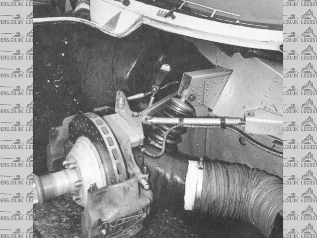

pgpsmith
| posted on 11/11/05 at 03:56 AM |
Maybe the long rack ending up near the top wishbone wouldn't be such a bad thing (for bumpsteer, anyway.)
Question for those with CECs: is there room for a rack behind the upper wishbone?
Hear, hear! regrading a fix to the pokey-outy trapezoid corners and wishbone attach point confusion!
I couldn't find anything in my files on attaching the nose. Somebody must have pics.
Thinking food from Alan Staniforth's Competition Car Suspension. Porsche 956-962 (Ickx/Maas fwiw.) Spacer block alters camber w/out changing
Ackermann or tracking. Tyres a bit wider, though...
Oh, and one vote for Ackermann and one for the front track being same as or wider than the rear. Admittedly they are
I-only-know-what-I-read-in-Smith-and-Staniforth votes.
Regards,
Mr. Pete
Live and don't learn, that's us. - Calvin and Hobbes
pgpsmith
| posted on 11/11/05 at 03:57 AM |
I'll try again with the attachment.
