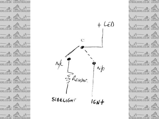

Put a resistor in the sidelight feed to the switch/led.
On side lights the led will be dim. During the day, no led on unless you operate the switch or put on your side lights (as per your tintop).
When the switch is operated, you will get full brightness to warn you that it is on.
This will be bright at night when operated and dimmer when not.
  savage switch
[Edited on 7/11/2006 by nitram38]

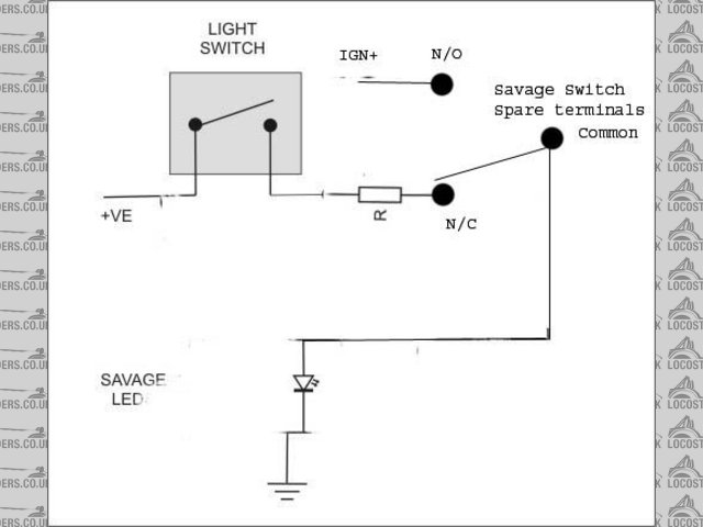

Nope, you lost me somewhere - here is a diagram of the bank of switches using a feed from the lights to give background lighting. If you activate one
switch and apply 12v to one led (to give warning brightness), surely all of them will light up. You would therefore need two leds for each switch to
achieve dual brightness (like K33ts' idea)

| posted on 7/11/06 at 05:34 PM |
Isn't that what I said?
Except, I have included a simple switching circuit provided by the spare contacts on the switch to swap from dim to bright operation, without the
added use of relays as per earlier posts.
My way provides two levels of brightness which does not require extra leds, diodes or relays.
Plus no back feed as switch swaps over for each individual led, so no cross over of feeds.
All you need is the correct resistor for each led!

| posted on 7/11/06 at 05:55 PM |
Still think you will need a couple of diodes to stop backfeeding the other switches though - like Rusty's diagram.
That way each switch will only brighten its own led when activated (as a warning lamp) and not all of them.
I think we may be at cross purposes here - two levels of brightness is easy peasy but adding a third level for 'warning' (with lights on
or off) is the tricky bit.
[Edited on 7-11-06 by RazMan]
