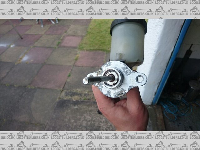

Well as promised. The fiat master cyl has arrived. No retaining circlip. Although I think would be very easy to knock up a retainer as the end of the
pushrod is domed.

Ah, bad luck, however, easily fixed with a retaining bracket attached to the pedal side of the bulkhead with that particular push rod.
![](/galpreviews/_20160107_191226.JPG) ![FabricatedBracket](/gallery/_20160107_191226.JPG) FabricatedBracket
I'll wait to see what Marc has to say before I do anything drastic. If I don't like the solution I may fork out for the Westfield retained
master cylinder.

I fired Marc an email to find out where he was up to with the new retained pushrod design. The response I got that he had already sent me the
prototype, and then the penny dropped, the curious looking bolt I received in addition to all my other parts WAS the push rod modification, intended
to be retained by the original master cylinder circlip.
![](/galpreviews/_20160523_185852.JPG) ![Push Rod](/gallery/_20160523_185852.JPG) Push Rod
Two minutes with a pair of circlip pliers, and the problem was solved
![](/galpreviews/_20160523_185921.JPG) ![Master Cylinder](/gallery/_20160523_185921.JPG) Master Cylinder

Bummer, the MNR push-rod fix doesn't work. It seemed like an elegant solution in principle, but the washer and push rod hold the master cylinder
too far in for the inlet ports to be exposed, so there's no way to get fluid into the system. A little bit disappointed if I'm honest, I
expected something more like my proposal after waiting months
