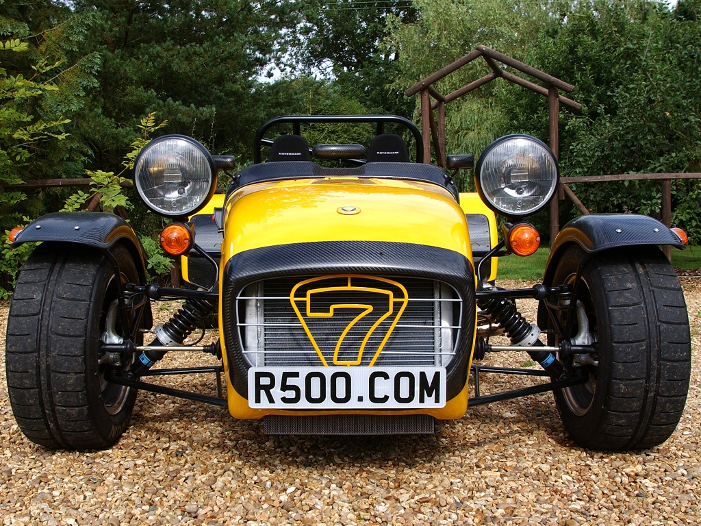

eddymcclements
posted on 21/1/04 at 11:44 PM |
Take a handful of stainless TIG rods and weld 'em together.
http://www.whirl.demon.co.uk/locost/se7en_grille.jpg
Any similarities to other small sports car from Dartford is purely co-incidental!
Eddy

eddymcclements
posted on 22/1/04 at 01:39 PM |
blueshift - I downloaded this photo
http://www.stevecarter.com/R500/r500-1024-4.jpg
enlarged the grille on the PC and printed it out, then just bent the TIG rods with pliers and fingers until they fitted the outline and blobbed them
together with the MIG.
Photo of grille in situ
Eddy
