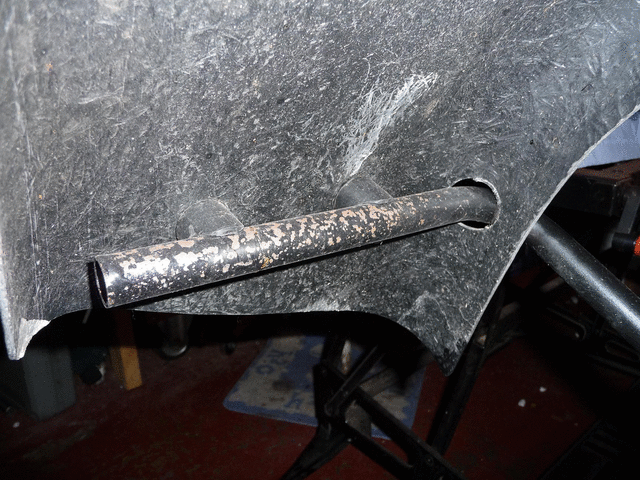

Way i did it..
From previous builds (MK, MAC1) the MNR cycle wings were the hardest to fit.
Long explaination but hope it helps,
I drilled 2 3.5mm dia holes through each side of the bracket. 2 at the front and 2 for the back for each side.
I then lined the bracket up with the wing and drilled 2 30mm holes through the inside wall of the cycle wing. (use a hole saw)
Pass the bracket through the wing, hold the wing flat/level and drill through the 3.5mm holes (from the inside) through the fibreglass. This ensures
all 4 holes are alligned.
Take the bracket out and drill out the 3.5mm holes to a 7.5mm holes to fit a m5 riv-nut.
As the bracket doesn't fit flat with the top of the wing, spacers need to be made. I made the spacers flat on one side and curved on the other
to sit nicely on the round tube. (4 spacers one for each hole)
Drill the 3.5mm holes in the wings out to m5 clearance.
Re-assemble bracket and wing, use long m5 screw, spring washer, penny washer, spacer. (Spacer sits between the wing and the bracket)
Note: if you choose to put the bracket flush with the flat surface of the cycle wing you will really struggle to get the wheel off due to the large
side over hang of the mnr cycle wing.
Plus i found the cycle wing was slightly larger in diameter than the bracket so putting it flush wasn't possible.
Have a look at my pics they might help.
I hope this helps a bit.
Cheers Gareth

More pictures
Ive added pictures to my archive that might help explain the way i did it.
The installation is more MNR specific.
![](/galpreviews/a858706-Cycle wing close up 2.GIF) ![Rescued attachment Cycle wing close up 2.GIF](/gallery/a858706-Cycle wing close up 2.GIF) Rescued attachment Cycle wing close up 2.GIF
