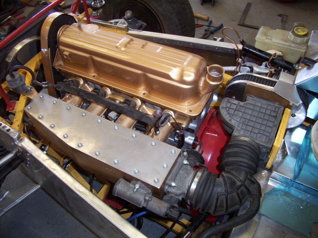

Mark Allanson
posted on 19/2/09 at 08:54 PM Reply With Quote
I have 10k under my belt with 18g steel on mine - no problems Rescued attachment Plenum.jpg
