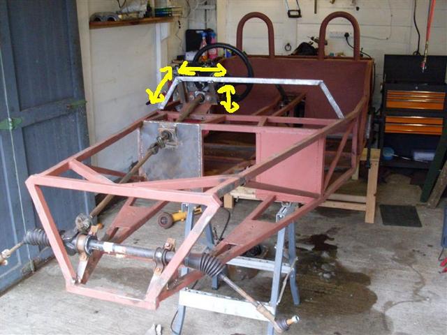

*davies144*
posted on 3/3/09 at 07:13 PM |
i bought my chassis with this already done to it but all the other chassis ive seen have a different support? and i cant find any thing in the
book!
![](/galpreviews/a899266-steering column support.JPG) ![Rescued attachment steering column support.JPG](/gallery/a899266-steering column support.JPG) Rescued attachment steering column support.JPG
