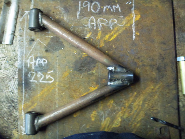

posted on 2/7/09 at 08:05 PM |
out with the old drawing again!
![](/galpreviews/a976214-Wisbone Modification.JPG) ![Rescued attachment Wisbone Modification.JPG](/gallery/a976214-Wisbone Modification.JPG) Rescued attachment Wisbone Modification.JPG
