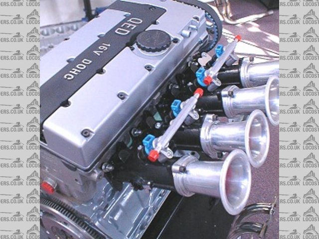

ned
posted on 5/3/04 at 09:57 AM |
My understanding is that tb's will always give slightly better performance than a carb as the ecu controls the amount of fuel issued by the
injectror, whereas a carb will just let the engine suck in as much as it can. tb's will be more economical fuel wise in this respect and another
advantage is once the mapping is setup they should never require adjustming, unlike carbs that can need balancing etc etc.
Due to the way the fuel maps on the ecu works they also generally (from experince of race engines) allow better pickup lower down in the rev range due
to teh better air/fuel mixture that the precise fuelling gives.
I imagine building tb's as already said is critical with variables such as size of butterfly, length etc. this i recon is where all te
research/moeny on jenvy's goes (as well as a nice casting!) for the vauxhall (and presumably other) engines you can now get direct to head
tb's which are tapered and ported to match the inlet ports on the head of the engine. parrallel tb's are the equivalent of carbs as they can
sit on the same manifold as 40's/45's.
tapered tb's are hence lighter in weight, better ported and flowed to the head.
all my 2p's etc etc.
ned.
taper tb's:
![](/galpreviews/taper_tbs.jpg) ![taper type throttle bodies](/gallery/taper_tbs.jpg) taper type throttle bodies
parrallel tb's:
![](/galpreviews/dcoe_tbs.jpg) ![dcoe type throttle bodies](/gallery/dcoe_tbs.jpg) dcoe type throttle bodies
[Edited on 5/3/04 by ned]
