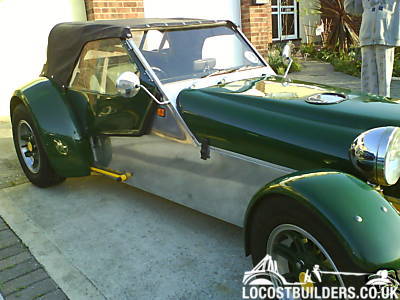

Hi all
Can some one tell me what the small yellow bar in photo is just curiosity really
and what are these cars like compered to tiger or westfield
Whats it like to drive with that very swept back windscreen
Steve Hignett
posted on 13/7/09 at 08:38 PM |
Yellow Bar is a trailing arm...

r1bob
posted on 13/7/09 at 09:14 PM |
As above,,,, anchored to the rear drive line,
i own one, i always drive on the open roads with the doors on, no roof gear and hardly get any buffeting, my door's are not full height like in
your pic, would'nt reccomended driving with out doors ,you would need an helmet, quoted as " arguably one of the best handling seven type
car.s" I never said that but it does handle extremely well,ideally suited too some one who is not to big, being smaller than the west field due
to the shorter wheel base. Have had good result's from my first season of sprinting,prob abit under estimated, may be im biased,
hope this help's
cheers r1 bob
JimSpencer
posted on 13/7/09 at 09:15 PM |
Hi
Further to the post above.
It's a 5 linked live rear axle, 2 bars run forward from the axle casing to either side of the chassis (i.e. the end you can see on the
picture)
Two run from the axle casing to the very rear of the chassis plus a panhard rod.
Gives very good axle location, reckoned to be THE way to do a live axle.
Compared to a Westfield a striker is physically smaller, particuarly short wheelbase. They are generally considered to be one of the best track
packages around, as can be seen by derivitives (Mk2 strikers and Fury's are basically the same chassis) winning the kit car championship on
numerous occasions.
They are used extensivly in club level hillclimbing and sprinting too
Dunno about the sporting credentials of a Tiger as never come across one on a track to compare against.
It doesn't really give any better location than a traditional 5 point linkage, but it does build in a lot of roll stiffness as it tries to twist
the axle in roll (which is why cracking the axle brackets is a common problem on them).
MikeRJ
posted on 14/7/09 at 08:09 AM |
quote: Originally posted by zilspeed
A pal of mine has to pedal his 1400cc Hayabusa Fisher Fury very very hard indeed to beat another bloke who has a Striker with a bog stock ZX9R engine.
They are very nearly the same chassis though, the Fury is just a little wider
procomp
posted on 14/7/09 at 08:23 AM |
Hi
As mentioned dose not give any better location than conventional. And is very restrictive in roll movement. Needs a LSD to aid traction. Fitting an
ATB is useless as the inner wheel is too lightly loaded to work. And no anti squat.
Cheers Matt
