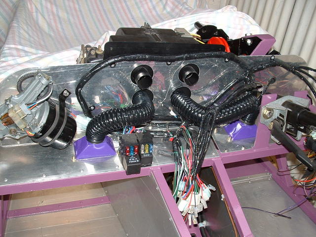

If the valve works on enertia, when they test the brakes on a rolling road, the valve shouldn't work since the car is stationary. I phoned Tiger
and they said it doesn't make any difference what direction the valve is mounted as long as the angle is about right. To me this seems to make
sense !!??!!
![](/galpreviews/a139871-DSCF0004.JPG) ![Rescued attachment DSCF0004.JPG](/gallery/a139871-DSCF0004.JPG) Rescued attachment DSCF0004.JPG

First off, makes sense to me... if the valve relies on intertia during decelleration then the valve must be orientated correctly to work.
secondly, a lot of people have binned the sierra valve and fitted one off a fiat Uno. this is adjustable and seems to be a better solution.
Finally.... A PINK CHASSIS !!! that's just wrong !![](/images//smilies/tongue.gif) ![](/images//smilies/tongue.gif) ![](/images//smilies/tongue.gif)
but seriously - any chance of a pile of piccies in your archive.? all sources of information are extreemly helpful and you seem to have done a few
things differently from your photo.... What is the steering column from? why the ally bulkhead ? etc etc
