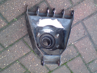

Back end rebuild continues
The car has been off the road for a couple of weeks while I have been rebuilding the back end and fitting the tranx diff I built up. Took the
opportunity to repaint the suspension and have a general clean up as well.
Replaced all the steel spacers with aluminium too. Just because...
![](/galpreviews/m_P1010562.jpg) ![Axle refitted](/gallery/m_P1010562.jpg) Axle refitted
Hubs fitted with new bearings and caliper brackets from andyw7de
![](/galpreviews/m_P1010564.jpg) ![Hubs and caliper brackets](/gallery/m_P1010564.jpg) Hubs and caliper brackets
And the calipers and discs test fitted. Required some minor mods to the caliper brackets to clear the caliper again.
![](/galpreviews/m_P1010566.jpg) ![Brakes fitted](/gallery/m_P1010566.jpg) Brakes fitted
Just have to refit all the brake lines and check the wheels fit over it all now! Fun fun
