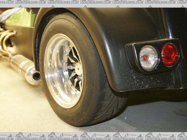

Wadders
posted on 29/1/11 at 06:38 PM |
I'm with you, but 205's will fit an 8.5" rim no problem, it just opens up your tyre choice a bit, IMHO anything wider is overkill
unless you have mega HP. pic below is a 205 toyo 888 on a 13 x 8.5" rim
