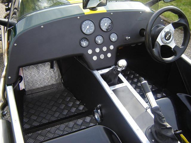

The Black Flash
posted on 16/3/11 at 04:06 PM |
A bit late, but anyway.
I used 1.5mm ally for mine. S'not finished yet as I'm going to cover the outer two sections and leave the centre console naked, as it
were. I bent it round a thick ally rod to get the radius for the bottom edge.
![](http://www.alfadax.com/content/during/06/passenger_panel02.jpg)
