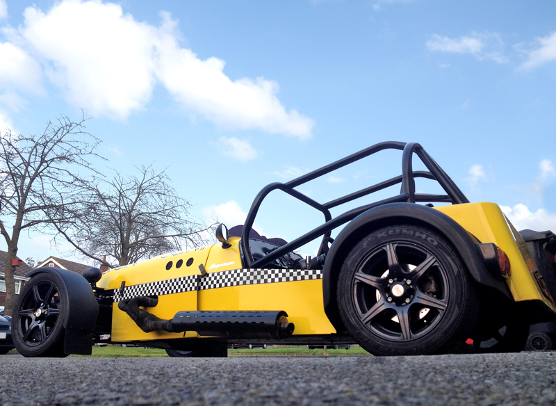

For now, here is the first photo of her at home, but being a photographer - they'll be plenty more.
Yes the heavy 15s will go along with the Kuhmo Ecstas, but got some reading up to do on whether to drop to 13s or not, as the FD is already at 3.14, so wouldn't want to limit my top speed much more...

dropping to 13s wont decrease your top speed as long as your on 205/60 at the rear
eerrrrrrrrrrrrrrrr
yellowcab
posted on 2/3/12 at 08:10 PM Reply With Quote
Awesome, Thanks... so the rolling radius on my current 205/50/15's is the exact same as a 205/60/13... in which case... what to buy...
I'm unfamiliar with even the PCD of my current wheels, I can only presume they are Ford fitment which I believe is 4x108... so I guess the R500 wheels won't fit as I believe they're 4x100...
What offset am I after, and also are they 6J fronts, 8J rears?
afj
posted on 2/3/12 at 08:27 PM Reply With Quote
the radius is about the same as 195/50/15 so may drop a couple mph my compomotive cxrs are 6 inch front 185/60 and 7 rear 205/60 and the off sets are about et27 rear and 23 front and seem to sit about right on my old 15s had 6.5 wide and et36. the only problem with 13s is the rear brake caliper clearance if using sierra calipers i and other here had to remove the coil return spring some on here have sourced a custom small spring, i just fitted a compression spring on the hand brake cable, wheel choise is limted to compomotive cxrs team dynamics pro race 1.2 and some expensive split rims oh think daniel mason on here has cateringvan wheels look very

I have r500's on my Mnr. 4x 108
Proby
posted on 2/3/12 at 08:47 PM Reply With Quote
Great pic Olz....
Andy B
posted on 2/3/12 at 08:50 PM Reply With Quote
We dropped from 7 x 15's shod with 205 50 15's to 7 x 13's on 205 60 13, the difference in diameter is negligible but we took 12kgs out overall. We are using pro race 1.2 wheels which are available in all the usual et offsets and ford fitment. Noticeable improvement in handling as well.

afj - thanks for the gen on the radius' and wheel/tyre options, will certainly be looking into them!
Daniel - nice one, always imagined r500 wheels were 4x100, nice to know they'll go on Ford hubs!
Proby - just a quick snap using the iPhone, not cracked out my proper gear & rig on it yet lol
Andy - looking forward to unsprung weigh advantage and handing too )
