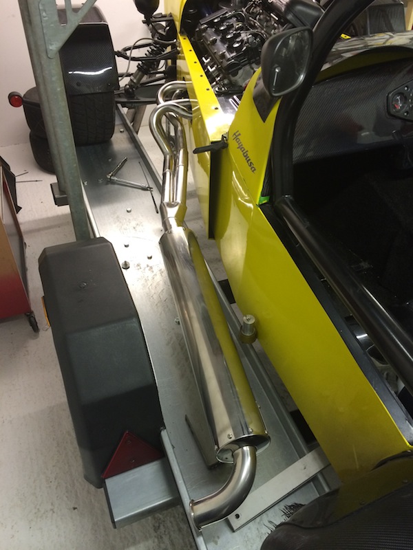

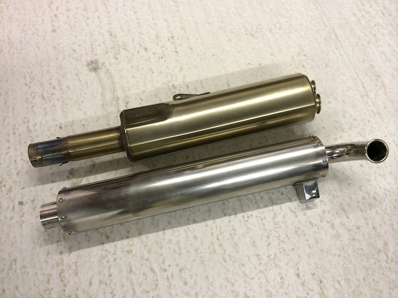

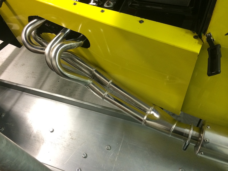

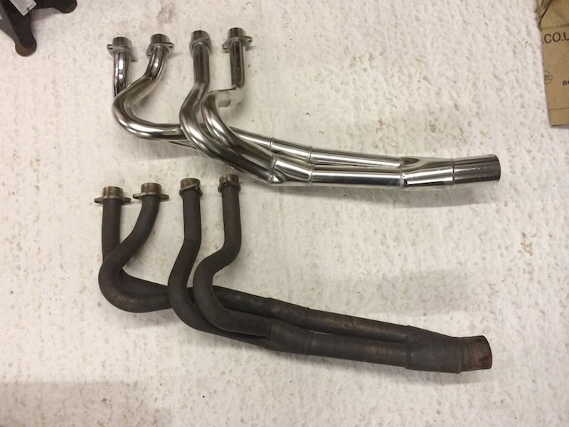

So popped down the garage last night to fit new manifold & rear can all went smoothly, but realised the original manifold had been slightly cut, so I can't chop & change cans quite as easily without moving the original cans rear bracket, which I'll do before Blyton.
Optimistic I know, but I still hope my new repack able can will be slightly quieter than my old Aprillia can… as long as its not physically louder, I'm happy.
30 inches instead of 20 inches…. but only 4.75inches diameter instead of 6inches

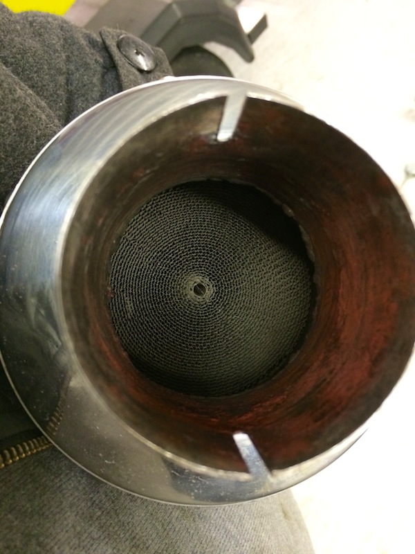

This genuine Westfield item seems to have a CAT at one end

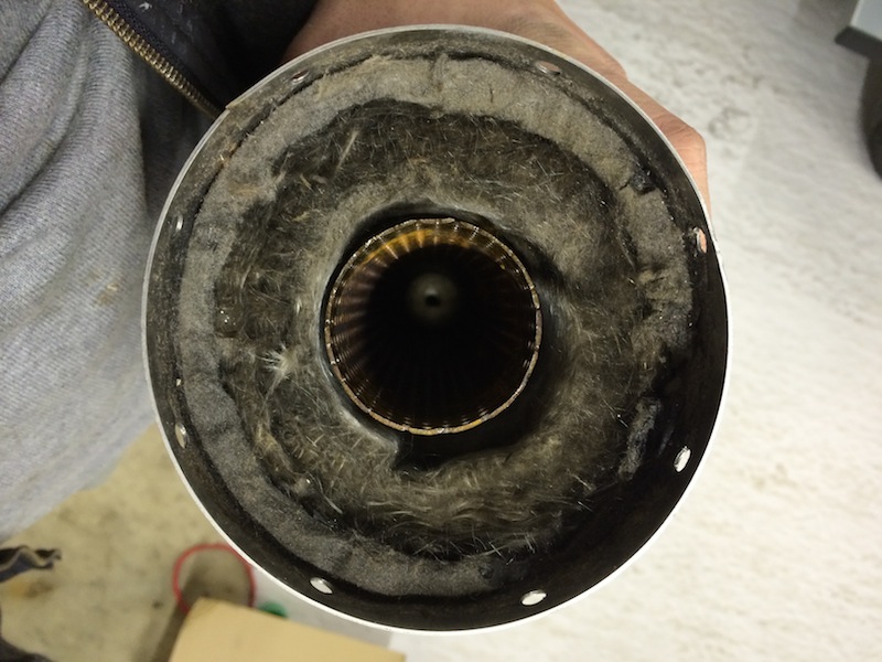

Whipped off the end cap where the tail pipe is, and it seems rather packed, so I didn't bother messing around with it

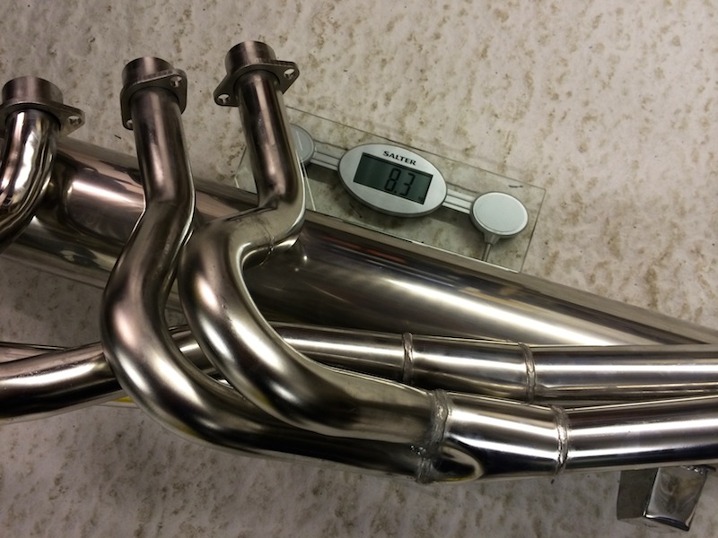

You can see the end of the old manifold had been cut about an inch off it
Old setup weighed a total of 12.2kg
New setup weighs 8.3kg… saving 3.9kg… I believe this puts me around the 507kg

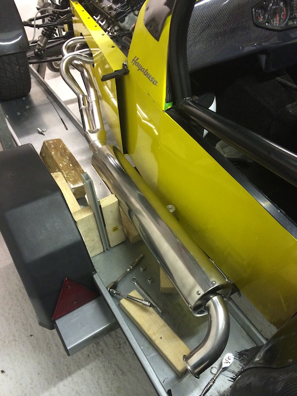

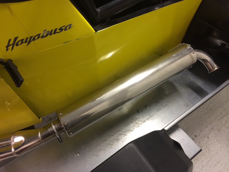

You can see the natural line of the Westfield items, the can gets further and further away from the bodywork, so I pushed it close and made a bracket in hope that the heat would allow the manifold to bend a little… but I've been told its more than likely going to crack
Bits of wood against the side of the trailer, meant I could get the box to run true down the side of the car
All done and dusted with nice shiny new clamp too, until it all discolours

I think you would be better repacking the silencer with Acoustifill (sp) It looks a bit thin at the bottom right.
Shouldn't be any gaps really.
Did you remove the Cat?

Cheers Dave
I didn't know the etiquette with packing, I heard you can overfill them which makes them louder like a straight through exhaust?
I guess that's not true?
If not Acoustifil, I presume loft insulation works too?
I left the CAT in , in hope it would also reduce the noise furthermore?

Just checked the pic again, the gap on the very bottom right was a sticky putty that cap off with the end cap
The gap around the perforated pipe though I can see
40inches
posted on 25/3/14 at 10:33 AM Reply With Quote
Acoustifil has to be the way, but not as much as they say in the calculator. Loft insulation will last a couple of minutes!
"Do it once and do it right"
I think I would leave the Cat in for the time being, a test drive will tell how restrictive it is/isn't. But if you take it out it will leave an expansion chamber, I good thing, or so I believe.
